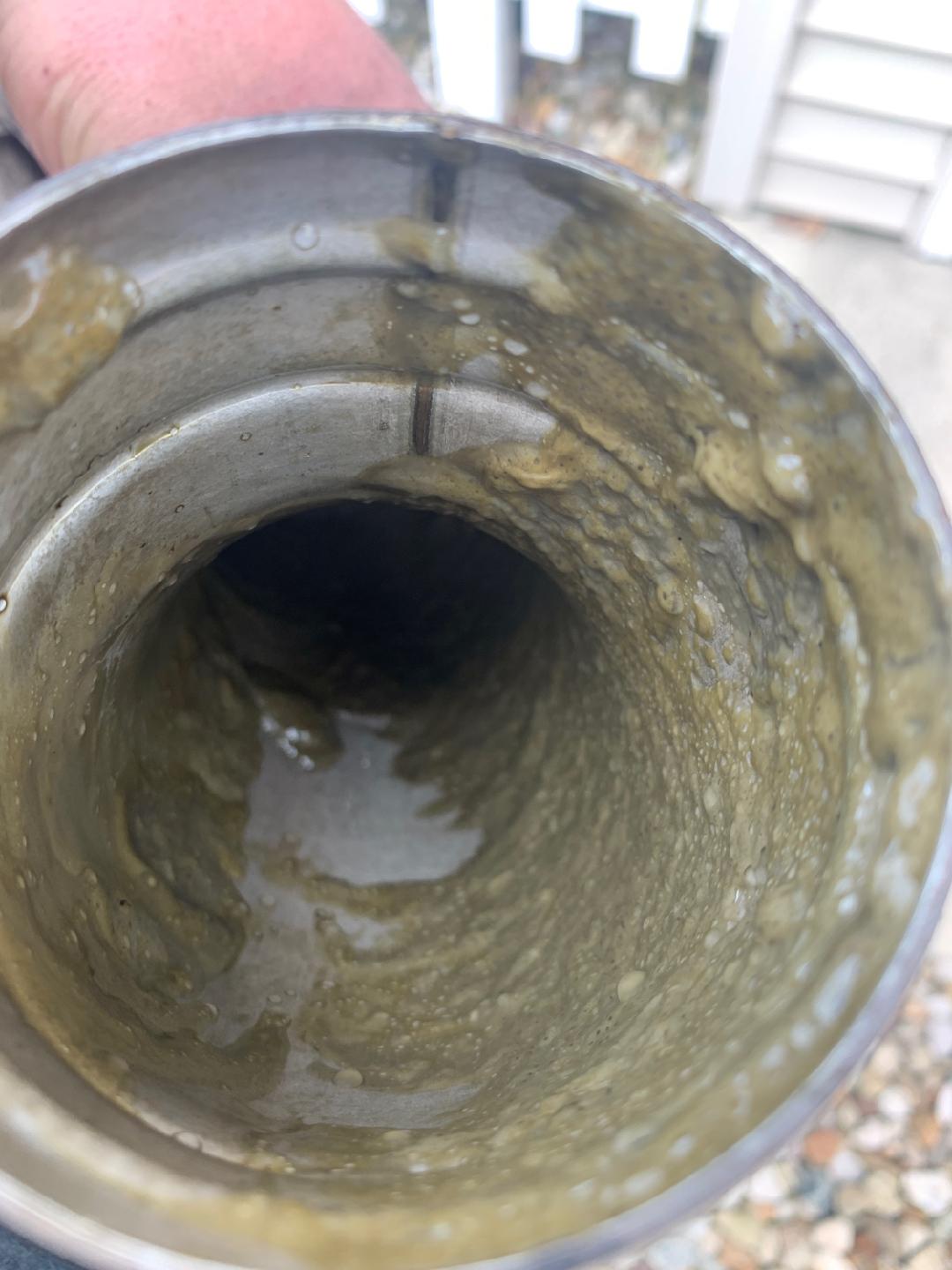

I may have found a boost leak at hot side intercooler boot, showing signs of air/oil making its way past the seal. Can't test drive it tho bc now I have a leaking radiator and lower driver side corner.

Radiator replaced, pulled intercooler boot, I have coolant mixed with CCV blow by residue on the intercooler pipe.what could this mean? Bad turbos or fcked gaskets? Still not throwing any codes.

well water of some sorts, not sure that it is coolant, didnt taste it.... its hot side pipe. or is it normal... ill try to post pics
jordysoso
Jan 23, 2017
119
Nowhere
Pics...
