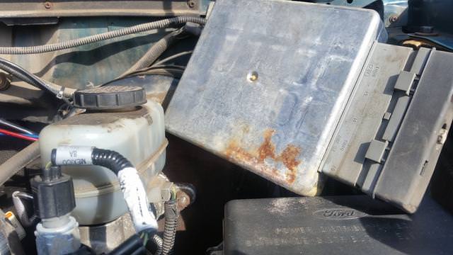

Fixed :rockon: :rockon: :rockon:
The lower 5 pins on the PCM were corroded. Cleaned up the pins/sockets, got a PW reading and the motor started.
