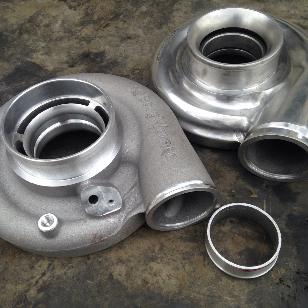

Just have to drop it off at the machine shop to get the v-band machined.

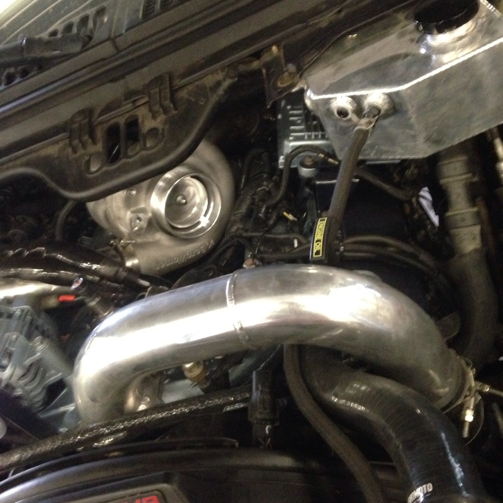

Well, it's in and runs. Spools about the same as the 64.5, ever so slightly worse. Definitely stronger once spooled, and pulls a lot harder on the big end.

Just dropped mine off to be machined too.
What did you cut the Oring groove to?
I measured 0.100" deep, and 2.45" ID. Iirc
I just gave them my other comp cover and had them match it. Hopefully you have some wiggle room with your piping, this cover is a bit shorter and at a slightly different angle to the vband.
Yeah I hope it fits.
I'd like to redo the discharge pipe anyways if it doesn't line up perfect....I finally blew the silicone boot last week.
I have better silicone hose couplers from HPS, but I would have to redo the piping, because they are twice as long.

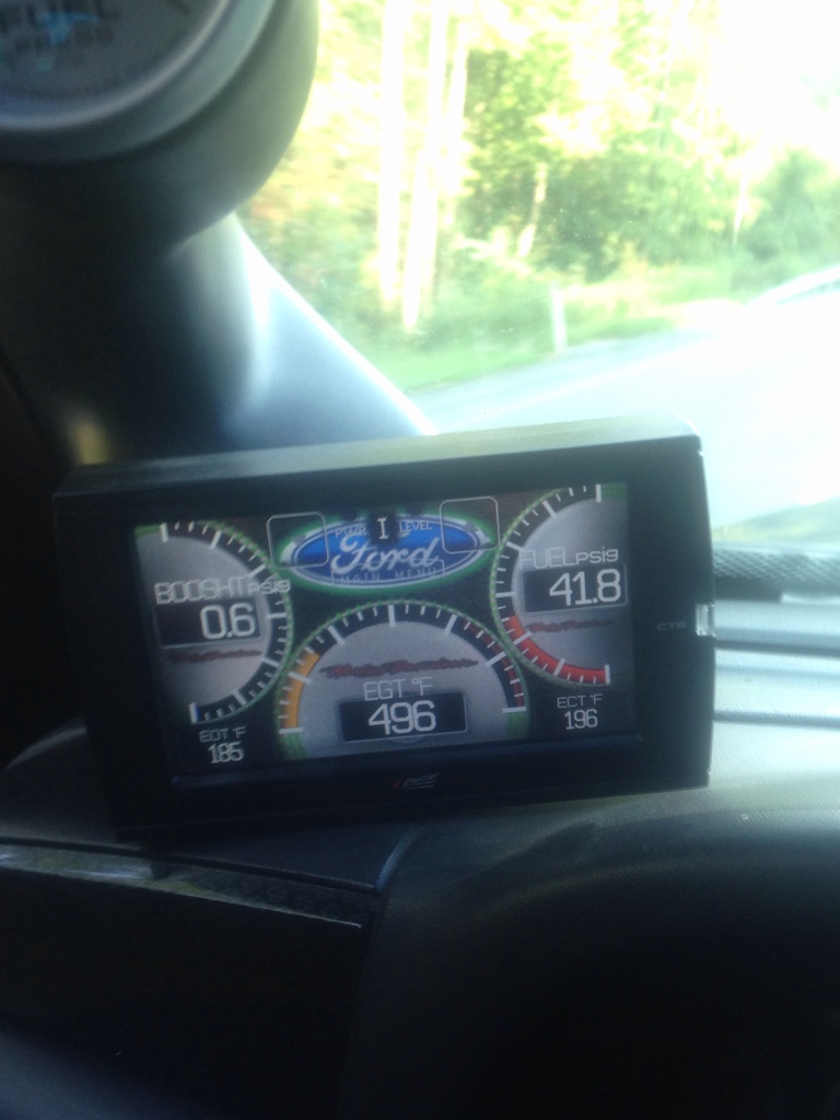

Had some people asking about my deltas.
After about an hour of driving. Oil temp is bottom left, coolant is bottom right. Upper right is engine oil psi, not fuel. My peak coolant temp record is 200*, cooling system is a lot more efficient when it doesn't have to cool the oil.
