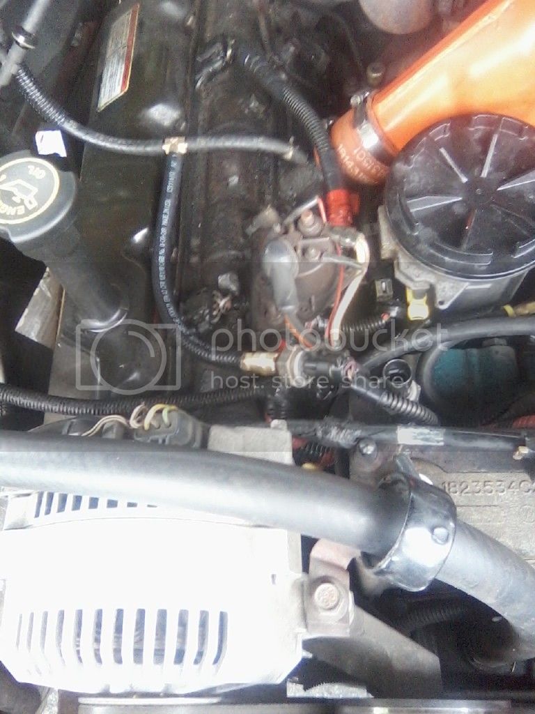

Tired of having a non-functioning EBP sensor as the tube was clogged, but didn't feel like dicking around with the tube now or in the future when it clogs again so i did this.
So far it seems like the shifts are much nicer now that the EBP sensor is reading something other than atmospheric pressure. You can also see my oil cap extension, Allis orange spider, and Navistar blue HPOP. Just wish the fancy colors added power. LOL
What pressure does yours read? Mine reads I think around 20 but it says the sensor is bad. My buddies reads around 14 I think
It should read 14-15 at idle/engine off. Running down the road it should keep up with MAP(boost).
My tube is plugged and kinked so it always read 15 no matter what, but would only rarely throw a code. But my truck is freaking weird about throwing codes. Used to throw EBP and overboost/MAP codes whenever i ran it hard, now it never throws em.

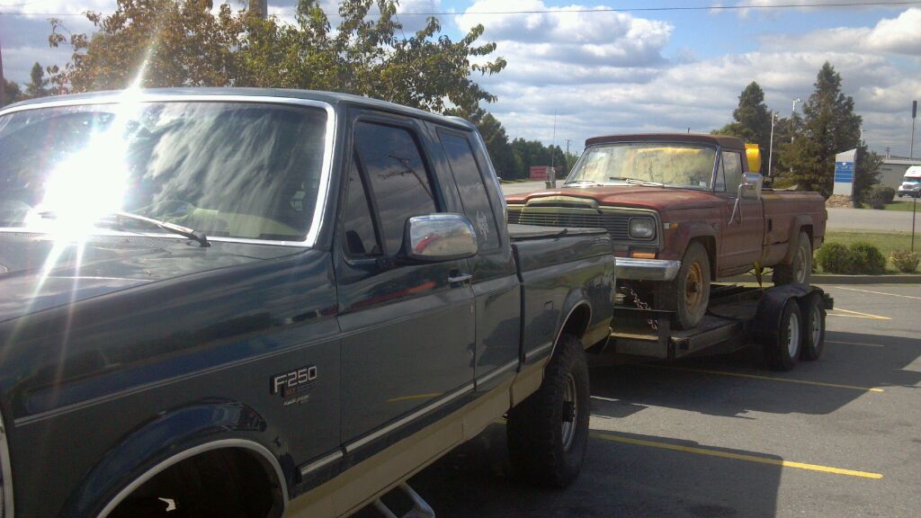

Back to Kentucky after dropping the vette off with new toy in tow
