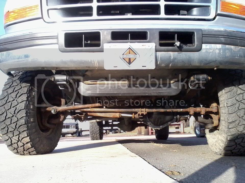

Needs some new tires lol
How much did it cost for the sas? Im wantin to do the same.

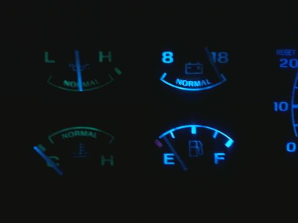

This hasn't had the green scraped off yet

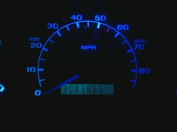

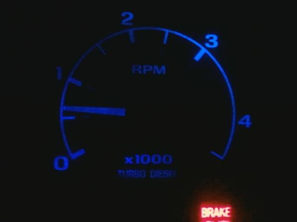

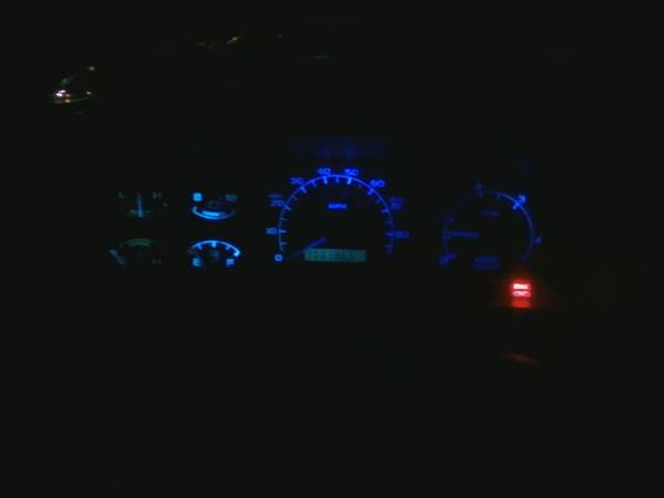

how did you get those so bright? i have red LED bulbs in my cluster but I can only see the needles
Yea i just dont want to have to rebuild the d60 first cause then i might as well just rebuild mine and all i can find are kinda rough.
I had to take it apart and scrape the green off the back of the gauges. Its kinda a pain to get the needles back in the right place (that's why my volt meter is so high) but not impossible
do you just have to mark where the needles are before you take them out?
you have to pull the cluster out, remove the plastic cover, drive the truck around and get it to normal operating temp, mark all needles at operating temp, then do your mods, get the truck back to normal operating temp, then re-install all the needles on your marks.
This works for temp volt and oil, the speedo and tach both go to zero when the key on engine off, and the fuel is easiest to wait till one of your tanks are full or empty.
this may be a stupid question... but why does it have to be at opperating temperature?
