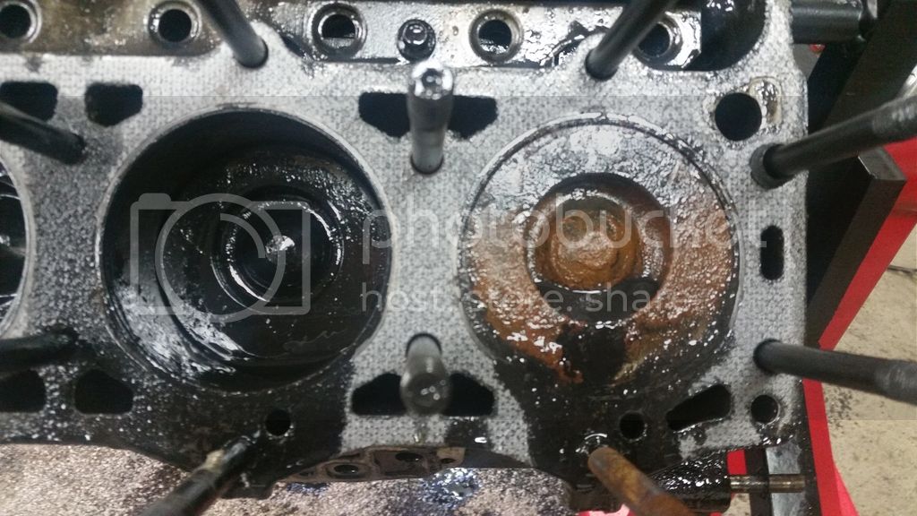

Ok I know it's been a while but u finally got a chance to pull my motor and get a look at it. This was cylinder number 8, there was also a good bit of water in my exhaust manifold on that side. This was the only cylinder that had water sitting in it like that. From I found so far it looks like someone did a half azz job sealing the front cover and that's what the gob of silicone was in my oil cooler. I didn't get a chance to pull the crank and cam yet to check for any block fractures in that area.

Well no block fractures and no visible cracks or anything abnormal with the heads. Any other suggestions to look at? I was hoping to find something a little more obvious

Crack or fracture might not be visible? My block and heads are at machine shop now getting magna-fluxed to ensure nothing is wrong before i put it back together. I would do that, its cheap insurance.

A crack could also open up under cylinder pressure, but if that were the case, i would think it would blow a hole in the cylinder wall due to so much pressure.
