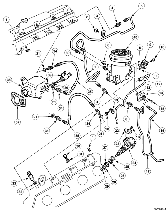

Item #35 are the HPO lines. Could also be o-rings #21 or fittings lose # 34. Clean the valley and then have someone start the truck. You will see the location of oil squirting out at high pressure.

It is a hpo oring somewhere... be it a line, be it at the pump, or the headplugs.... Fill it with oil, start it up, and see where it is spraying from.
