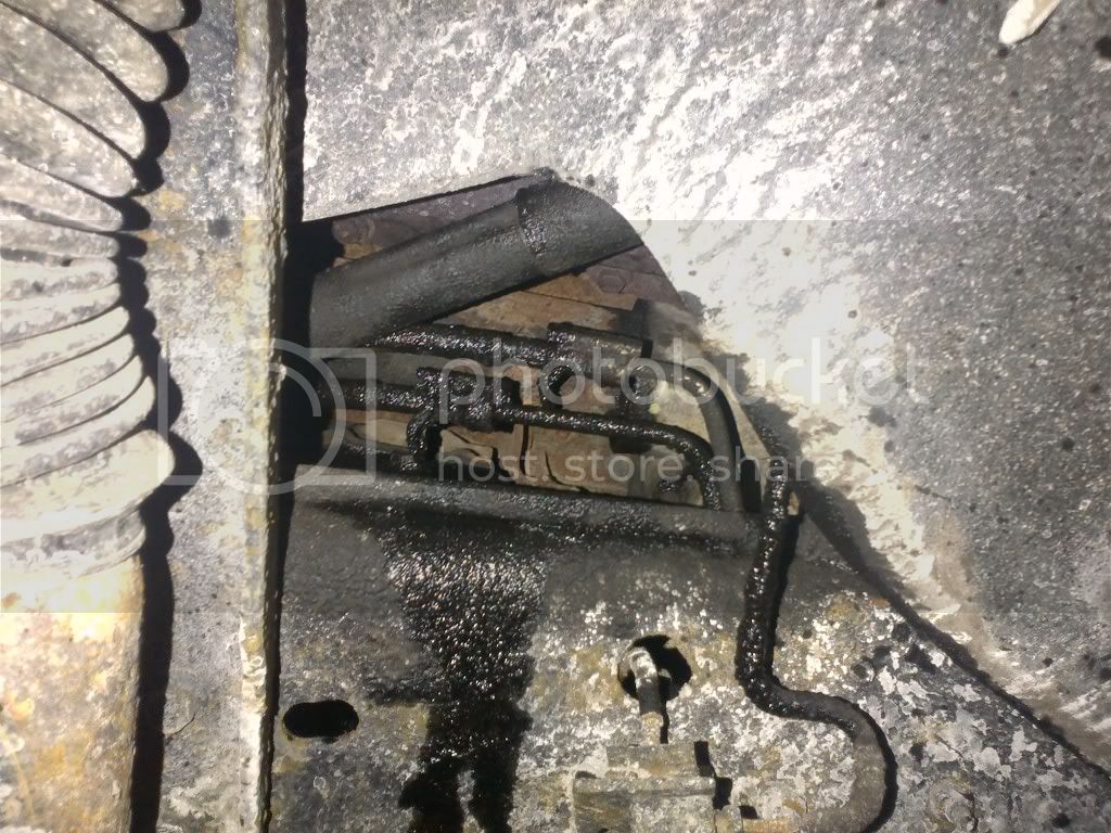

Would be worth it to verify rear high pressure oil plug is leaking. Mine had enough that it ran down the side of the block onto the filter and on to front end. ImageUploadedByTapatalk1359016627.440899.jpg

That seems to be whats leaking... there was nothing leaking above it, there wasn't much any oil next to it, and there was a TON of oil below it.
That pic is of the drivers side wheel-well, which happens to be where all the oil is plastered up in the well. Directly below that piece is where it appears to be a ton of oil all over my springs, diff, etc.
Are you leaking oil or fuel?

Its def oil.... there was a good sized oil puddle under the truck yesterday. I haven't noticed any fuel leaking at all, nor have I smelled it. That pic was taken at night, so the clarity might not be great.
I ask because those are fuel lines. If its not fuel - then that's not what's leaking.

Hmmm. I couldn't find anything leaking from above there that coulda been leaking though... most everything above was dry..

Didn't get home til 10pm last night so no. Was just trying to find the highest source of oil that I could with what I had to work with at the time

well i can see in the picture that your steering shaft also has oil or something on it. do you have the ccv mod or does it still go to the intake? possibility that the ccv tube came out of the intake boot if dont have a ccv mod done, also check valve cover gaskets which is right above steering shaft
