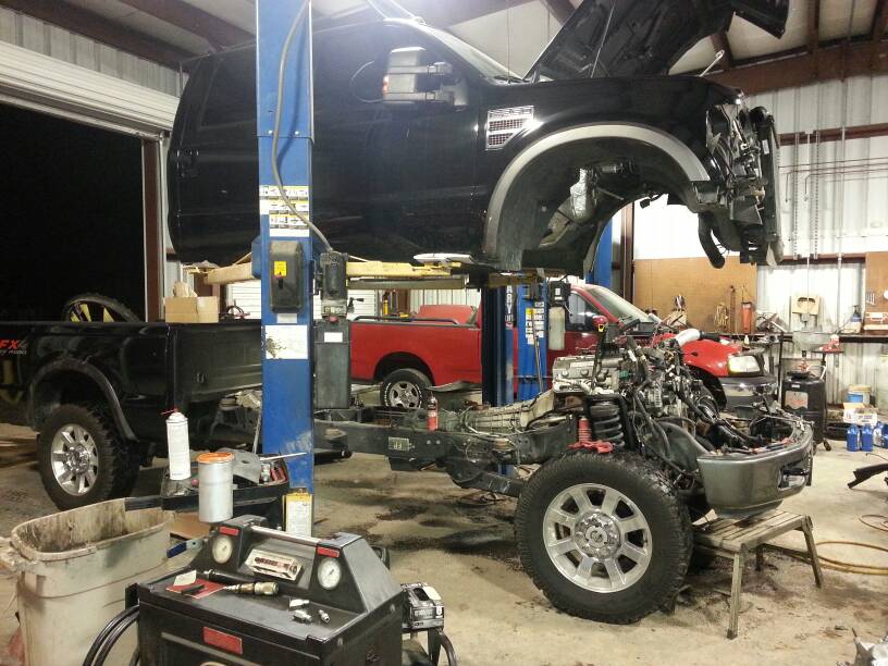

Had to drive it to the shop. Starting the repairs tonight.

Tore it all down last night, going back together today.

Got everything back together and drove home tonight. I replaced a few things while the cab was up to include;
New belts
Fuel filter
Switched to 5-40 Valvoline synthetic
Oil filter
Flo-Pro EGR delete with elbow
New thermostats
new coolant
New oil temp sensor
Radiator hose o-rings
Sinister coolant filter kit
switched out my 4" exhaust for a new 5"
and of course a new oil cooler.
On the ride home the biggest temp difference I saw was 6 degrees. I'm happy now. I would have liked to replace the radiator and do the heads but the bank account wasn't in agreement.
