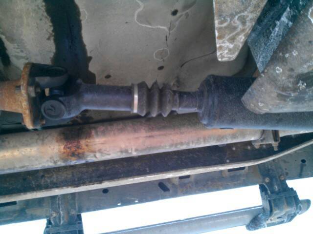

I just recently swapped my rear to a one piece, as described with a slip joint near the tcase. It's really smoothed the vibrations out. Crewcab short box.

Around the $650 mark. extra heavy wall material. I was assured by the driveline shop That I won't break it sled pulling.

It's steel tube. 1480 joints. Drive Systems Inc. (DSI) It's a local Calgary company, they do tons of industrial shafts mostly, for the oilfield, drilling rigs and highway trucks.

Just shot a couple quick pics of it for you. We'll see how it holds up, but looks decent, I don't have any concerns with it at all yet.
