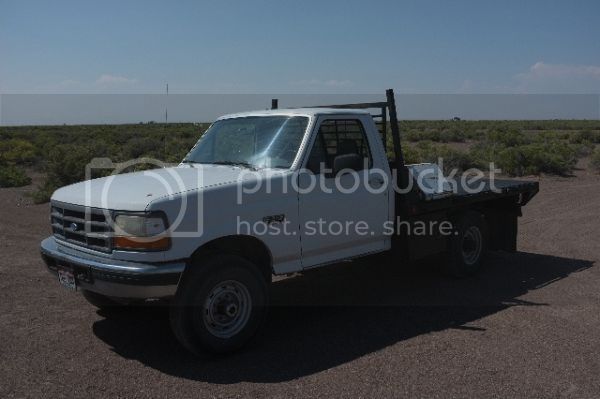

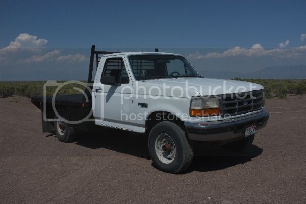

Here are a couple pics of my rig. Trying to decide on keeping the bed or not.
And some Sh!thead stole my passenger side locker. Seriously...
Not a bad truck for being a 95' and only 157k on it. All stock... I mean completely. A/M only ford radio for christ sake.
