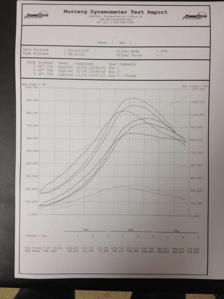

Attached are the two dyno charts of Adrian's white truck.
The one chart with three runs are all on fuel only.
The chart with just a single run is when we tried to spray it after the heads were already ruptured.

Thanks to everyone, it is just one dyno result so now I have to back the numbers up. The hard part was just getting the number I hope, if backing it up is harder then I might just give up now.
