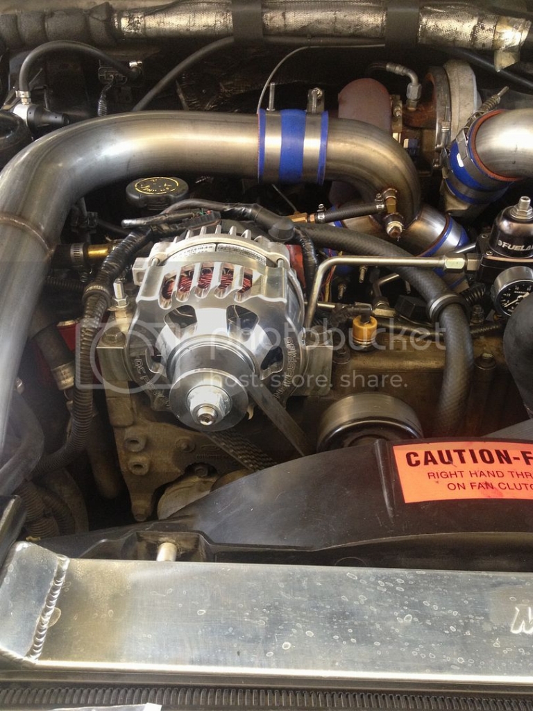

Finally got my DC power 190 amp alt.. It's very well built
It was very worth the money IMO. Made in the USA too.

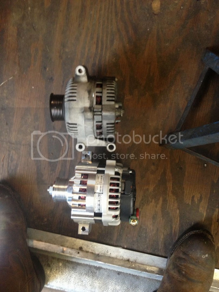

Sorry guys, i have so busy i have just been toughing threw the issue and havent got it fixed yet..... i noticed today that my tstat is leaking so that might be more of an issue than the clutch itself..... i have a new fan clutch on the bench though....
I am going for a 10 day trip with just the truck, on friday, but as soon as i get home i will tear into it....
On abother note..... my alternator was litterally coming apart.... one bolt that holds the case together was missing and the others were loose.... went and got the "newer/upgraded" one and still have the voltage issues.... maybe its the leaking coolant, on the belt, causing slippage?????

Or the fan is.blowing it into the case and.washing the bearing lube out and soon it'll lock up, sideload the.shaft, and break it. Then you'll get stranded.

Well since I quoted you, you should know lol
Coolant. Blowing. Into. The. Case. =trashed alternator. Been there, done that.

I did but at the same time i noticed i had a colant leak at the t-stat housing and it was getting colant on my belt, make it sticky when cold and slippery when hot.... cleaned all the pulleys and got a new belt... so far so good
