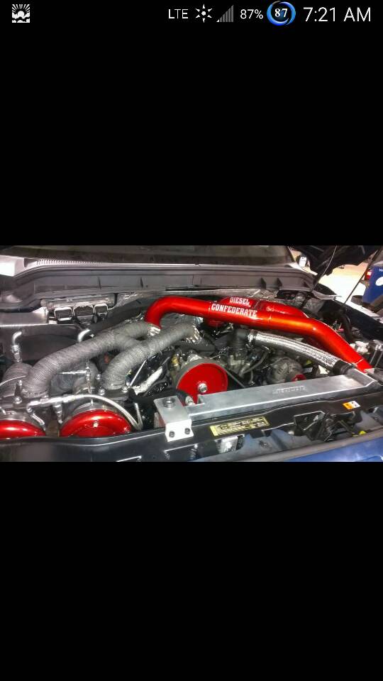

Confederate diesel had parallel EFR's on their 6.7 for awhile, went back to a big single though.
