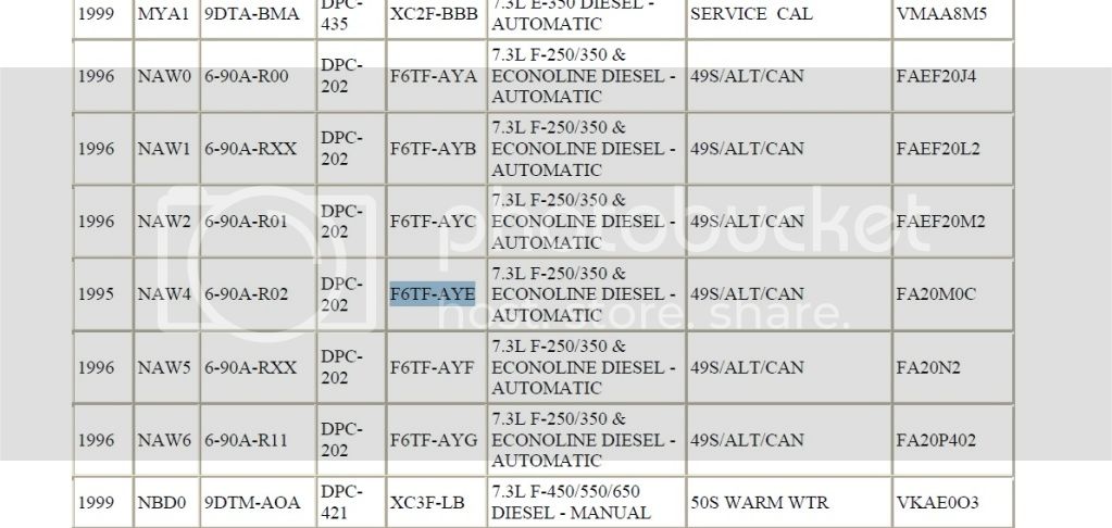

I have a line on a 96 F250 that the owner says needs a new PCM. The PCM number is F6TF-12A650-AYE.
Does this number sound right? Can I buy a different PCM and have the truck run right?
Any suggestions are greatly appreciated.

49 state, and Canada PCM.
NAW4 is the PCM code it's actually listed as a 95

Sometimes the PCM sellers list the PCM by the DPC number, which is the same for the entire NAW series. DPC-202 according to the chart.
