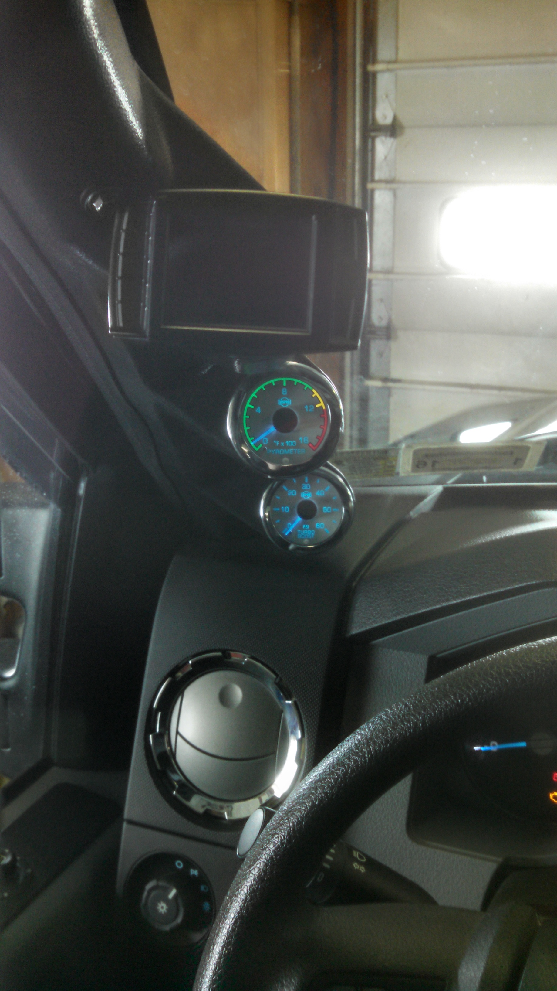

Finished the wiring/install for the gauges today. The fittment of the SPE pillar pod sucks. The wire harness for the pillar airbag is partially exposed...and the top portion of the pod doesn't fit good against the headliner. Overall....the setup looks good...just wish the pod fittment was much better.

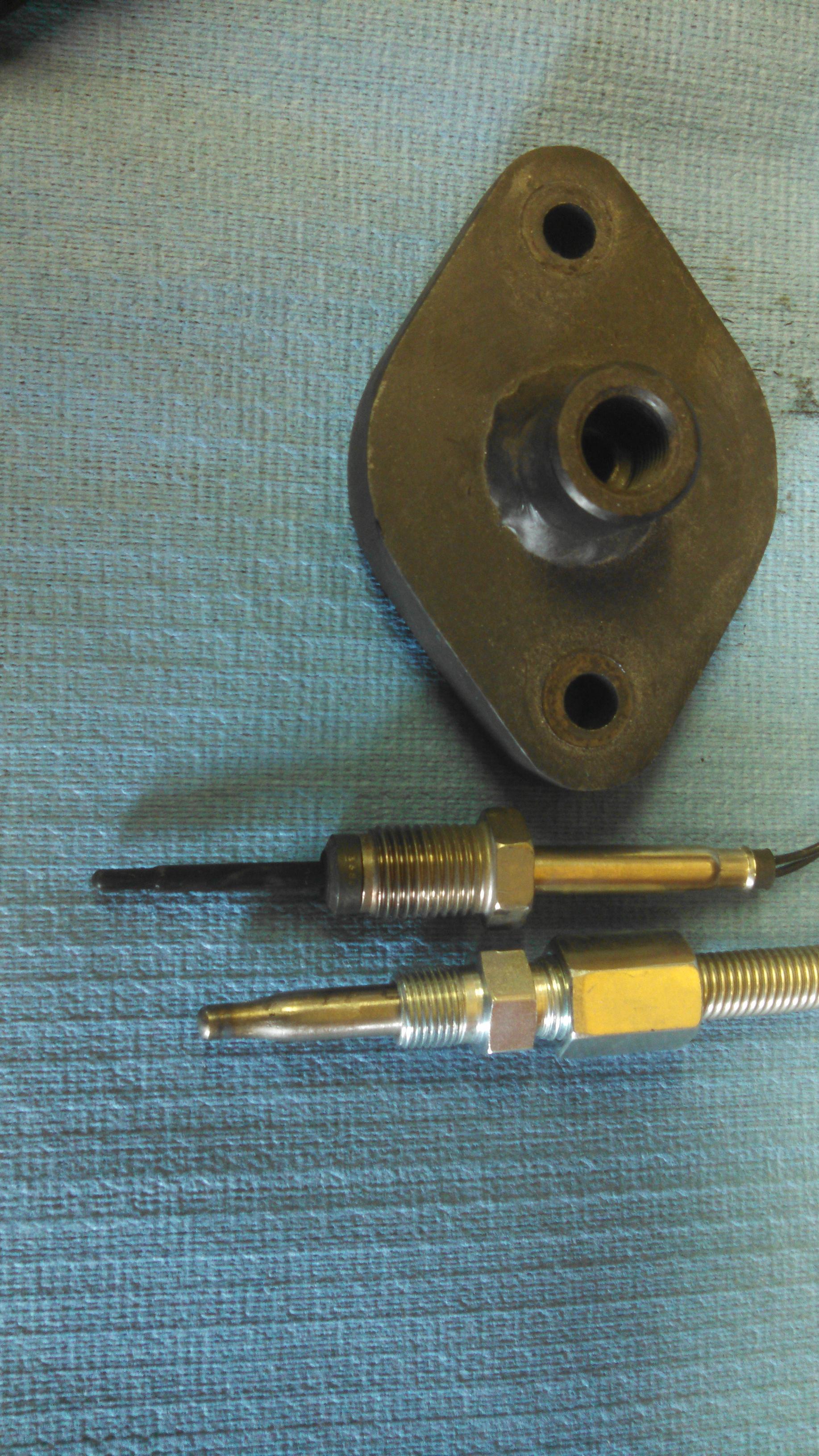

Ran into a issue right now tho. Only thing I had left to do was install the probe for the ISSPRO gauge. Pulled the factory probe out and found that the threads on the ISSPRO egt probe are different size and fitting is also smaller. What to do? Build a new flange with the right sized thread bung for the ISSPRO gauge or does someone make a flange for an aftermarket egt gauge

cut that bung off. tap the hole in the plate itself once the bung has been removed.. had to do the same thing with mine. it will also get that probe down in there farther doing it that way which is good for a more accurate reading.
You think you could take some pictures of where it doesn't fit good bc I want to get this set up but very picking when it comes to stuff I have to look at everyday
