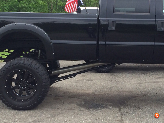

I have fixed bars because of Trevor's recommendations. I have a 14" lift in the truck, for the floating bars to work properly they need to be parallel with the frame so they are good for a stock height or slightly lifted truck he told me with the size of my lift I was better off with the fixed bars. My truck has all PMF parts in it they are Top Notch!!
I went with the weld on bars fixed and I love them!!
I can't believe that with that much lift and the bars at such a steep angle they don't bind the rear suspension like crazy. As the suspension compresses they going to be trying to move the rear axle backwards a lot. The mounts must have more give than I think they do.
Thanks for the pics.
