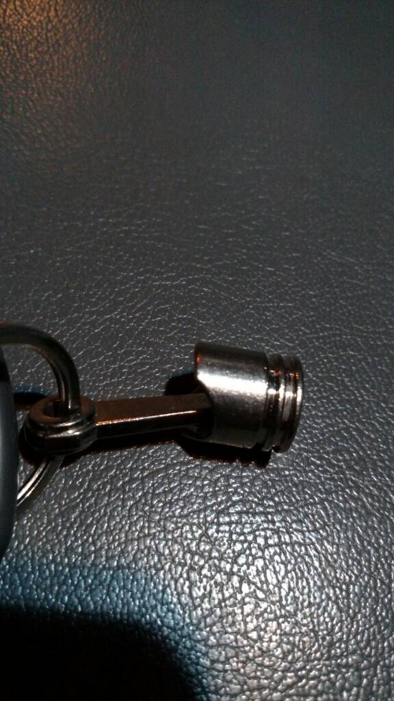

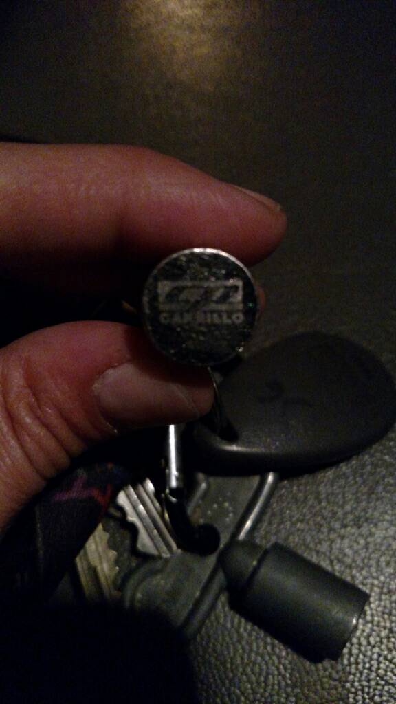

My vote goes to Carrillo rods right now based on experience seeing them used in a variety of 7.3s and the price point.
I have one of their miniature versions right now...
LOL
LOL
Sent from my XT1254 using Tapatalk
That thing is sweet! How can I get one?
