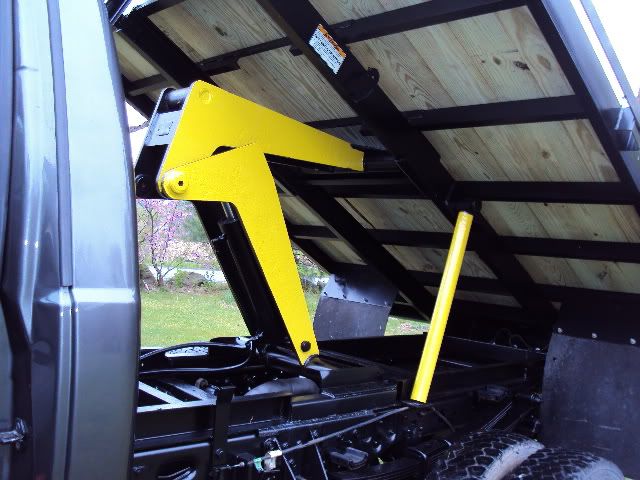

Here are some examples of some POR15 projects
What I started with
Before sandblasting
Sandblasted
POR15 and topcoat(yes I had body up to sandblast and paint)
Going back together
Bottom of cab sandblasted
Then for and topcoat
Some of the finish with the valspar topcoat
