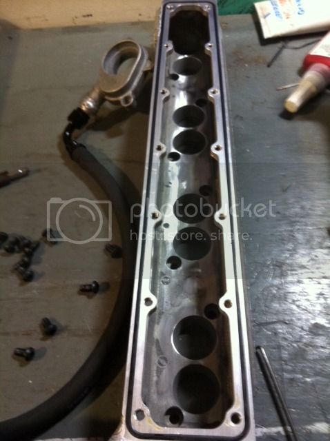

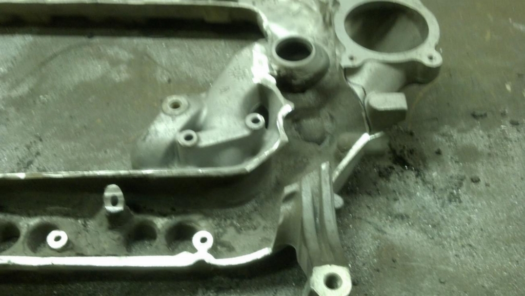

This:
Or this:
Whatever brand you choose a ported intake will make a difference.
