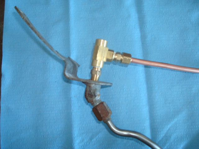

Matt, now that you mention the EBP sensor...i've seen some pics of guys with coiled copper tubing with the boost line attached to it. Is this what you have attatched to the T-fitting, then the boost line attatched to the copper tubing? If so how many coils of copper did you make and what size are the coils? I have the fittings and copper tubing to get the reading from the EBP sensor, now i just need another boost gauge.

use a couple feet of the copper and coil it up so it can cool before it hits that plastic crap lol. thats pretty much it.

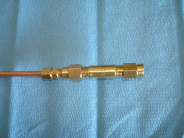

Does it matter where the coils are...whether they are close to the EBP sensor or at the other end towards the 1/8" nylon boost hose? I'm guessing probably more towards the EBP sensor so that they cool the exhaust enough that it doesn't melt the nylon...right? I got it at LOWES and they didn't have 1/8" like i wanted only 1/4...so i got 1/4. Here's some pics i got mocked up from the EBP sensor bracket and tube.
second pic is of my soot filter i made...and filled with some fine steel wool.
yeah i forgot to tell you about a filter haha. mine is steel wool to just a little longer than that.
