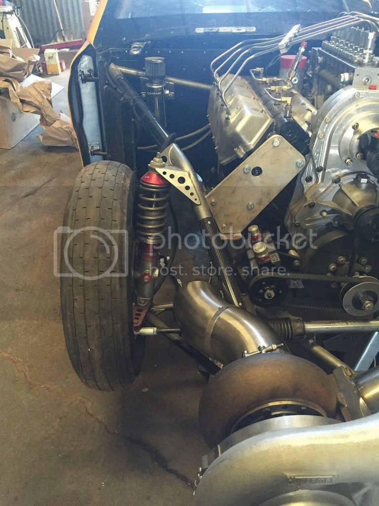

going to do something like this for the exit. front clip is going to be cut around it and Duzed to the chassis so we dont have to worry about taking the exhaust apart to get the front clip off.

That should work. Looks much better than the turning radius of a school bus now... How long till that carbon fiber plate catches fire....

How about a heat shield for the oil pump and belt area. I wouldn't want the heat to damage that belt.... I know it's early in the build

It's not near close enough to that belt to be an issue. No wrap that is just extra unneeded weight at that point. I was going to paint that tube with header paint and call it good.
Plus this motor doesn't run crazy hot EGTs as one would expect. I was told to exspect 1500* EGTs right at the exhaust port.

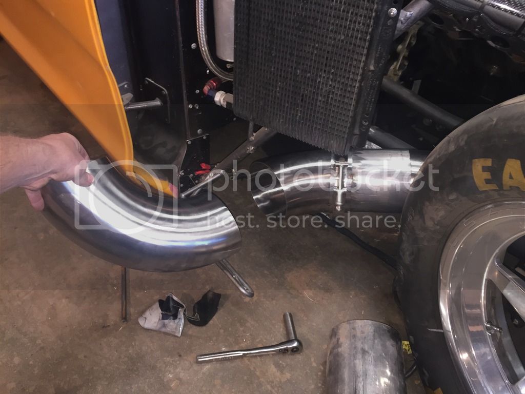

I was about 4" short of thin wall stainless to finish the exhaust but it will be something like this. And before anyone asks there will be a mounting tab in the middle to suport that weight.

looks awesome. is that a chunk of stove pipe behind the tire?
