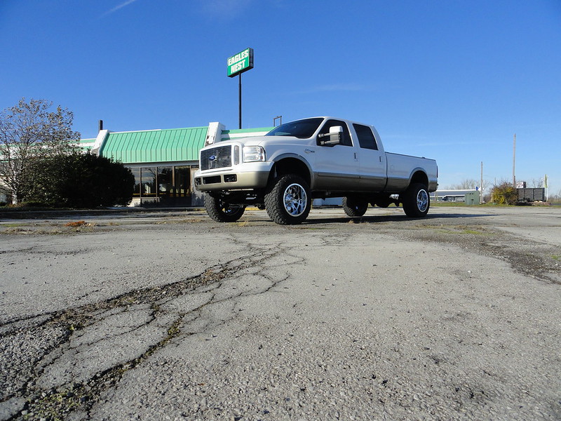

I did pull the 66mm turbo off and I am running a BW 63/68/.84 T4 divided housing. I love this turbo, spools quicker, pulls harder on the top end and towing is 100 times better now. Im still running 25* timing, hope to dyno it again soon just to see.
I also added 2" more lift and 20x12 chrome fuel throttles, currently Im just running 16x8s and 35s for the winter.
Also put a new front end on, paint matched bumper and harley grille and will be building a new rear bumper soon.

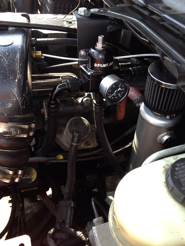

Been a while since I updated this. Ive made a few more changes so I figured Id share. I have a little over 53k miles on the build now. I just moved and started my new job so the 86 is on hold at the moment while my buddy is finishing up painting it back in ohio so Ill spend a little time on this truck. First off my airdog motor kept crapping out, 4 times acutally. So I got fed up with replacing motors and decided to build myself a nicer quality fuel system. I went with fuelab on this truck to give it a try since I did aeromotive components on the 86. So I bought a fuel lab 51505 pump and regulator and baldwin filter bases. Ordered up my fittings and line from jegs and after making some mounts this is what I came up with.
image by mattpopiel, on Flickr
Ive been very happy with it, holds 48psi no problem and stays reliable.
