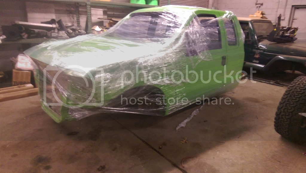

Well the body is finally back.
So hopefully this will get going again very soon.
