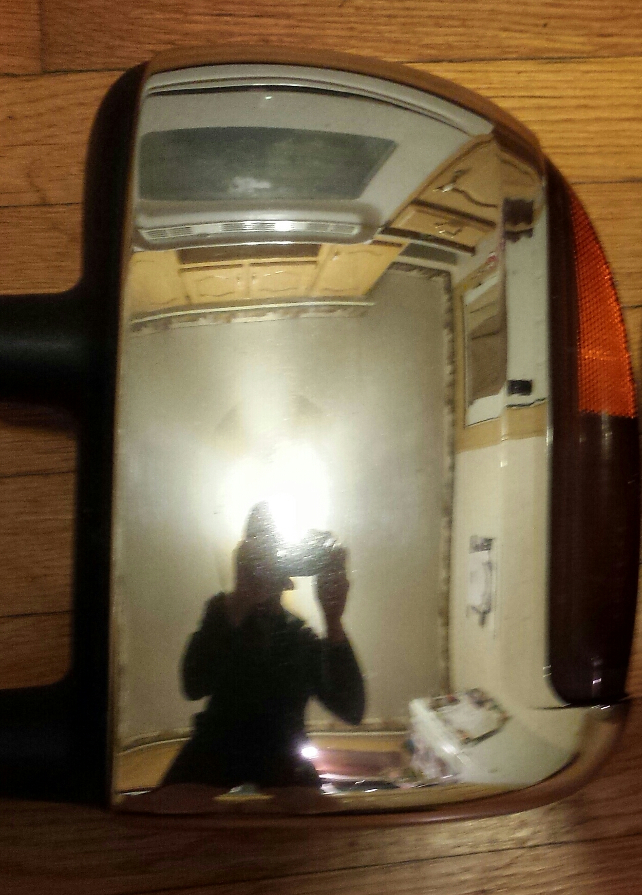

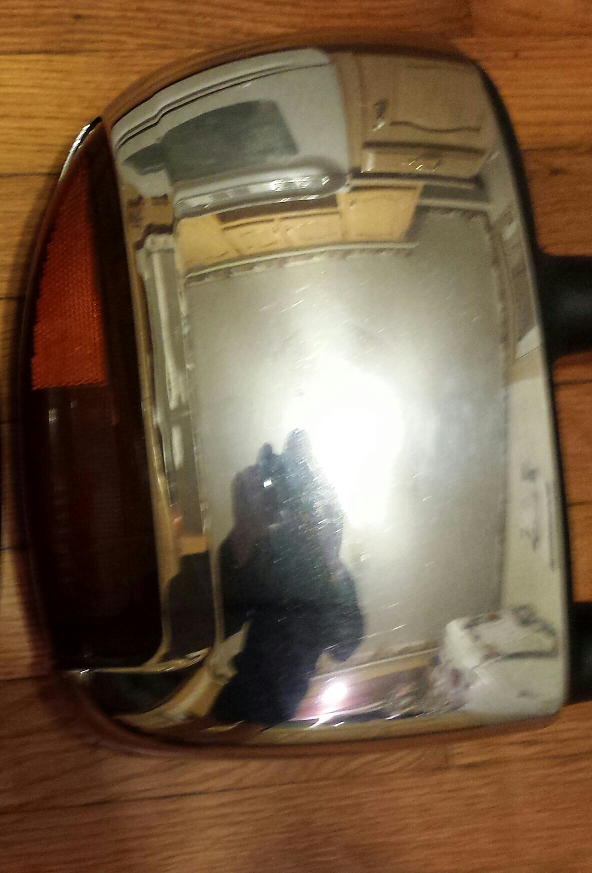

Got these beauties picked up today, 100 bucks for the pair, om originals with chrome covers with turn signals and heat and of course power adjust.

Mirrors and axles are in the future for mine as well. How much did the axles cost you? I just want to find an 03 or 04 Dana60 to sawp in. I want to reuse my 2000 steering knuckle since I have Dynatrac ball joints I want to keep.
Nice truck btw.

Rascal, I think I got real lucky with my axles, came out from under a 2004 with 90k on it that never pulled a thing in its life. Bought mine for 500 bucks, thanks for the comment on the old truck, it is definitely a 50 footer right now but come spring that will change, 800 bucks for a running driving truck isn't bad though.
