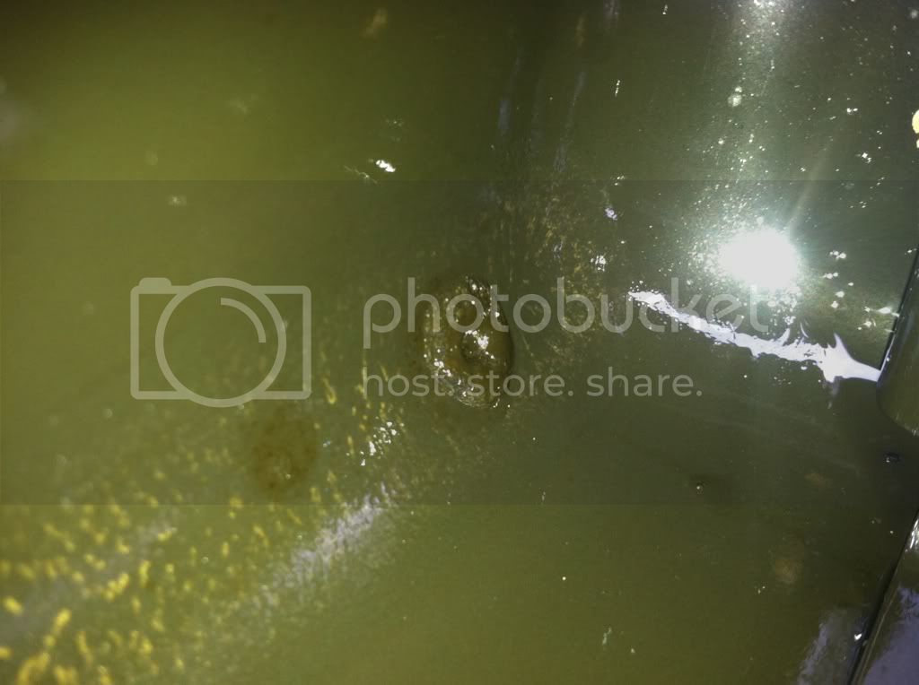

On the inner oil pan can it be powder coated? I found a couple of rust bubbles. I will see how much it would be to sand blast and powder coat compared to a new one. Just was wondering what is a good coating for the inside of the oil pan.

why coat the inside of the pan? rust starts on the outside, that's where i would clean up and coat.... for the cost of a new pan, and the pita factor, i would replace it if you have rust bubbles coming through on the inside.... i wouldn't get a cheaper aftermarket pan though.... had bad luck with one, not worth the chance go OE

Well I think I'm good on the pan my 99 had the rust but the one I'm using on the build seem good. I had on spot but it doest look to be rust. It looks like its part of the pan or when it was made because its to perfect.
Here is a pic:

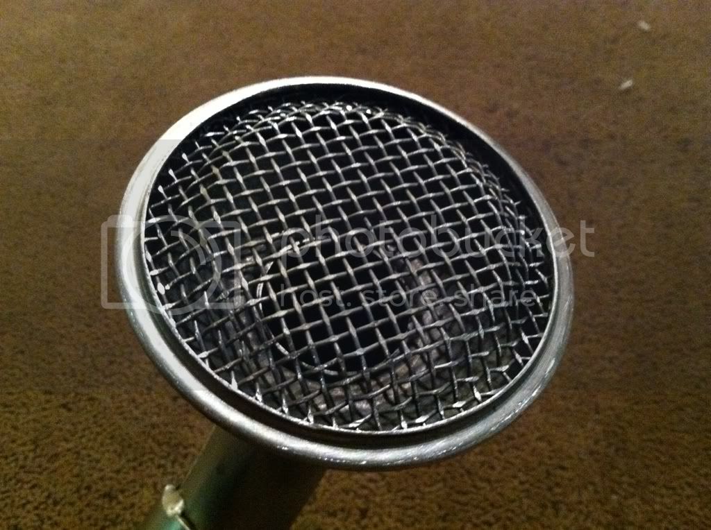

We install new pickup tubes in all our motorbuilds. They are included in our main stud girdle kits...

JDud are the pickup tubes from ford? I had to order one from ford . It seems they used some sort of solder on the joint compared to the original where it looked to be just tack welded.

JDub on the pickup tubes,do you guys or anyone else do this mod to the hood of the oil pickup tube?
