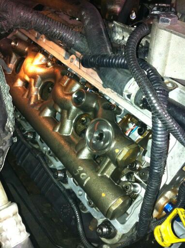

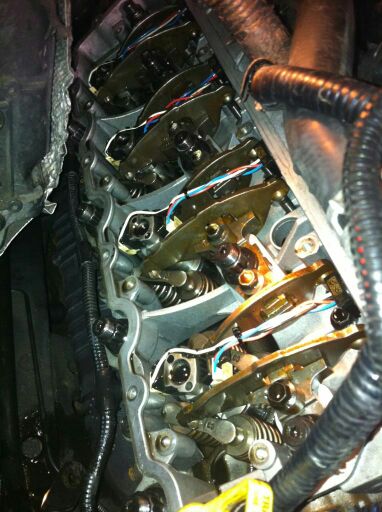

Guess Jason has the valvecovers off...
G Racing
1,643
Southeast Texas
Shipping injects in the am. Pulled the spool valves. Everything looked good and clean. A little rag lint on the screens. Still had a miss on #3 that had little effect on a balance when disabled.
