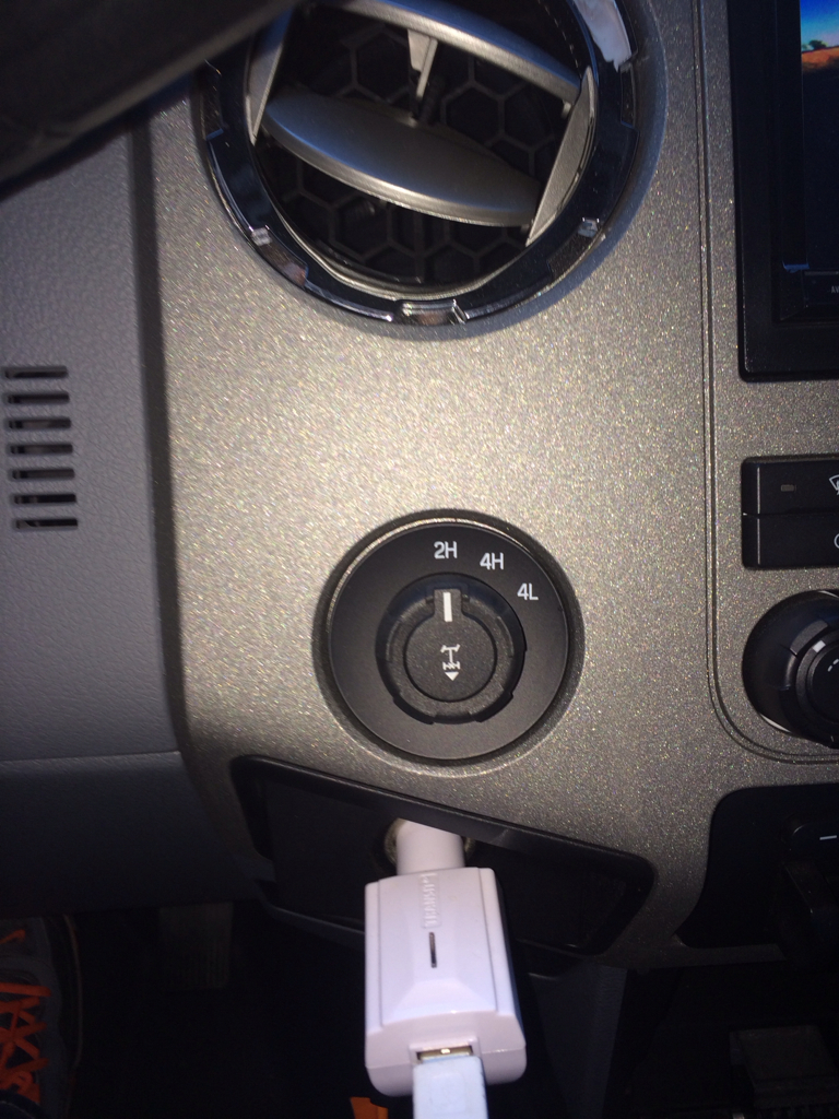

i dont think the 4x4 knob would pull out if the truck didnt have a rear locker. a light on the dash should come on when you pull it out, and it will automatically kick off and unlock once you get over 20 mph. thought the rear locker would be sweet for racing, but then ford screwed us there by having it un lock automatically. SPE makes a kit where it will lock and stay locked. but i dont use it enough to invest in that feature. But it comes in handy when your taking off from read lights or in stop in go traffic with a heavy load behind it. As well as pulling your boat out of the water up the boat ramp, that makes it a nice feature to have and use.

Yes a light on the screen pops up when I pull it out. It is a drive train looking symbol with an X between the 2 rear wheels.
I think it is the same symbol as the 4x4 except there is no X in between the front 2 wheels.

It will still pull out even if it's not equipped with the e locker.
If you're going over 20mph does the dash say to slow down to 20mph to engage locker?
live life full throttle
No it didn't say that but the symbol will go off over 20mph and I can feel somthing disengage in the rear end. Then if I turn or slow back down the symbol pops back up automatically if the knob is still pulled out.

its worth the 50 bucks or whatever to get the SPE kit that keeps it locked at all speeds. its very simple to exceed 20mph while spinning.

Lol what a genius. I just realized the damn symbol to pull out and lock the rear is on the knob.
