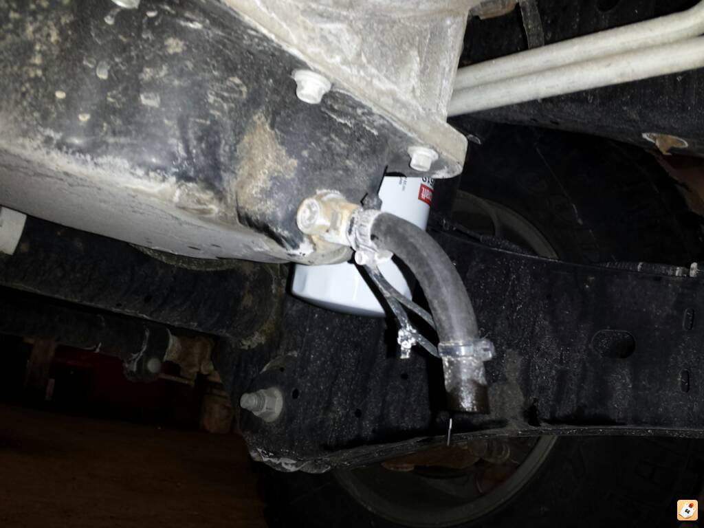

Didnt realize I could have bought a 90° fumoto valve until after I bought this one but I recommend this to ALL 6.7 owners. Way cleaner this way. Lol... first time I changed the oil I got covered in it... both my 7.3s have them. Way way handy. Zip ties are just to keep it curved.

i have a fumoto for my truck havent gone far enough for an oil change. but mine is a straight as well.

I need to get a fumoto for the wife's Escape. It does the same thing as the truck: shoots straight out the back if the pan. At least they didn't go with the early 6.7 setup with the 1/4 turn plastic plug. I hope that engineer got fired.

I think this was my second oil change with it in... very nice and clean. Other then the oil filter being a messy SOB,even with a punched hole in the bottom, is the only messy part..
The 1/4 turn plug just seams ***ed up. Ive never messed with those..

I have yet to figure out how to not have oil pour out over the entire filter even with a hole punched in it.
Yeah, evidently the anti drain back on these filters are spot on... ive punched a couple holes in it in various spots and let it drain till it was done dripping and still to have a lot of oil run out over it.
FM theory...
Its bull
i have just been loosening the filter and draining into a container with a funnel. still not super clean but better than the hole.

just ordered fumoto valves for both trucks. Had one on the 6.4 and loved it.
Hell yeah man!
I recommend putting a jack under the front diff and lifting it up. If not, some of the old oil stays in it cuz of the rear facing plug and the thickness of the threads on the valve. Unless you guys dont care about a little old oil leftover. As black as the oil is, id rather get it all out!
