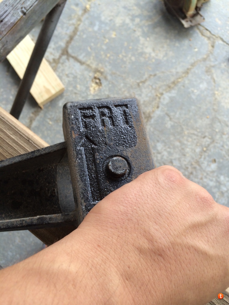

Ok so how bout this sh*t!
Took the first side off and guess what. The f*cking idiots had them backwards! It clearly says FRT with an arrow pointing so you know which side to put them on because of the slant that they have for the axel and drive shaft to line up.
How f*cking incompetent can an individual be to do this.
Weird part is the truck never had any axel wrap or vibrations from the driveshaft being out of alignment.

Maybe this is the next mod. Can't afford traction bars? Just swap your rear blocks! :badidea:
How much taper did the Ready Lift blocks have?
I didn't measure both sides to compare but if you look at the second pic you can get an idea of how much.
From what I saw however the axel rolled back a good 3/4 of an inch or more when I put the other blocks on the correct way.
