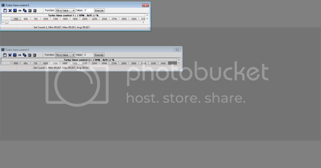

If we had EFI Live, you can see those tables and could adjust them to make it equal, but I am not sure if you can get them on MCC. I assume if you contact H&S they could probably do that for you. Hopefully, they are the same which would make life simple.
You mean.....like this :thumbsup:
You would just have to figure out what the voltage is on a 6.0 i assume and tune from there.
