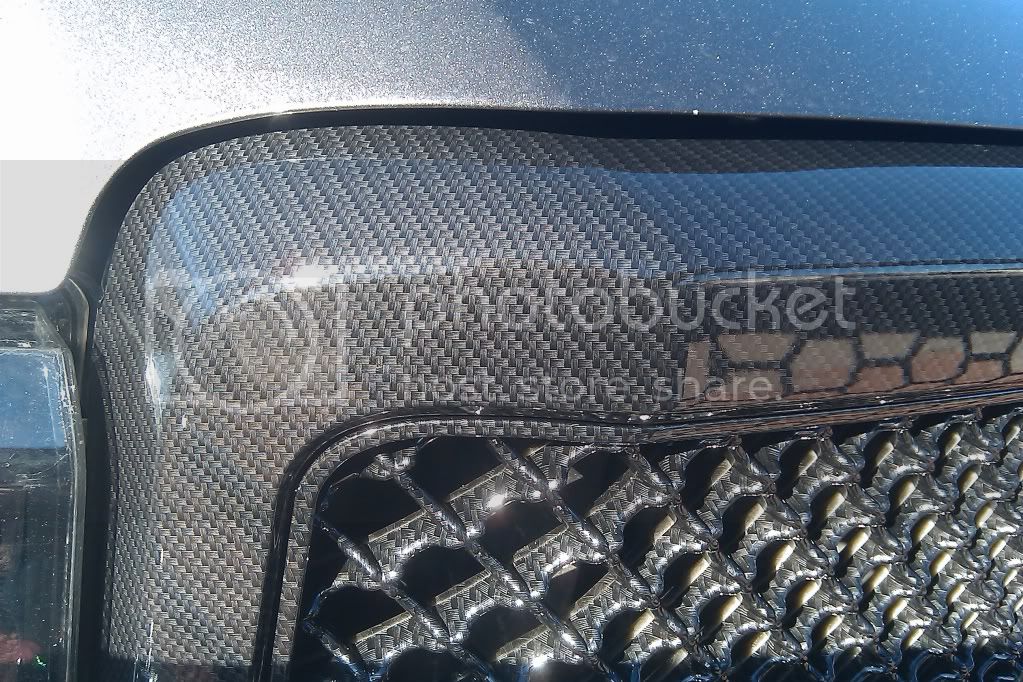

I'll have to look again. I couldn't find the black tight mesh on there just now.
How's the quality and fitment?
Fitment is great, ran one on my 6.4 and my 06 6.0......the "carbon fiber" held up way better than the straight black on the 6.4, but I had it professionally painted by then

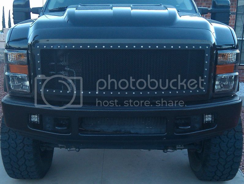

Any complaints on the hood on your shorty Julian? Idk if I want to run a traditional cowl or the on you have. I'm kinda iffy that yours will look too aggressive
Fit and finish could've been way better......but if I ever get it painted, its nothing a decent body shop can't iron out
