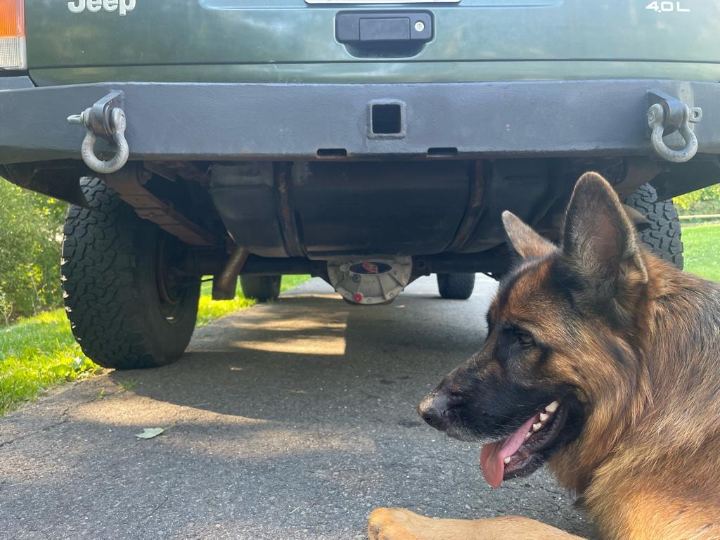

I put these G2 covers on the jeep
They were not too bad pricewise.
Don't mind Henry
He feels the need to be included in every picture.

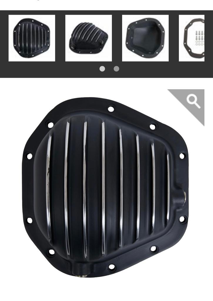

Let me ask a stupid question...
Are all Dana60 covers the same?
Such as ford/gm/ dodge
Also are the covers the same front axle or rear axle?
I will be looking for an inexpensive good looking cover for both front and rear.
Haven't had much time to research but I did do a quick search today and summit racing has their own brand which looks pretty cool.
But I'd like to get matching covers

That will probably not work in the front. If you look at stuff like mag hytec and others, the front has a flat spot that starts about 1/4 of the way down the cover, to the bottom of it to clear the steering linkage

All the obs rear ends where 10.25 single or dual rear wheel.
Any 10.25/10.5 rear diff cover will work. Same housing and bolt pattern.
4x4 Obs f350 Front is dana 60
4x4 Obs f250 fromt is the ibeam(wtf ever they called it.. junk) dana 50

Thanks.
As far as the flat spot on some dana 60's
I think any cover will work
My steering linkage is a good distance away from the cover.
No chance of contact.

When you turn full lock is when its the closest. Have someone turn the wheel all the way both ways and hold it then measure it to see how far away stuff is.
