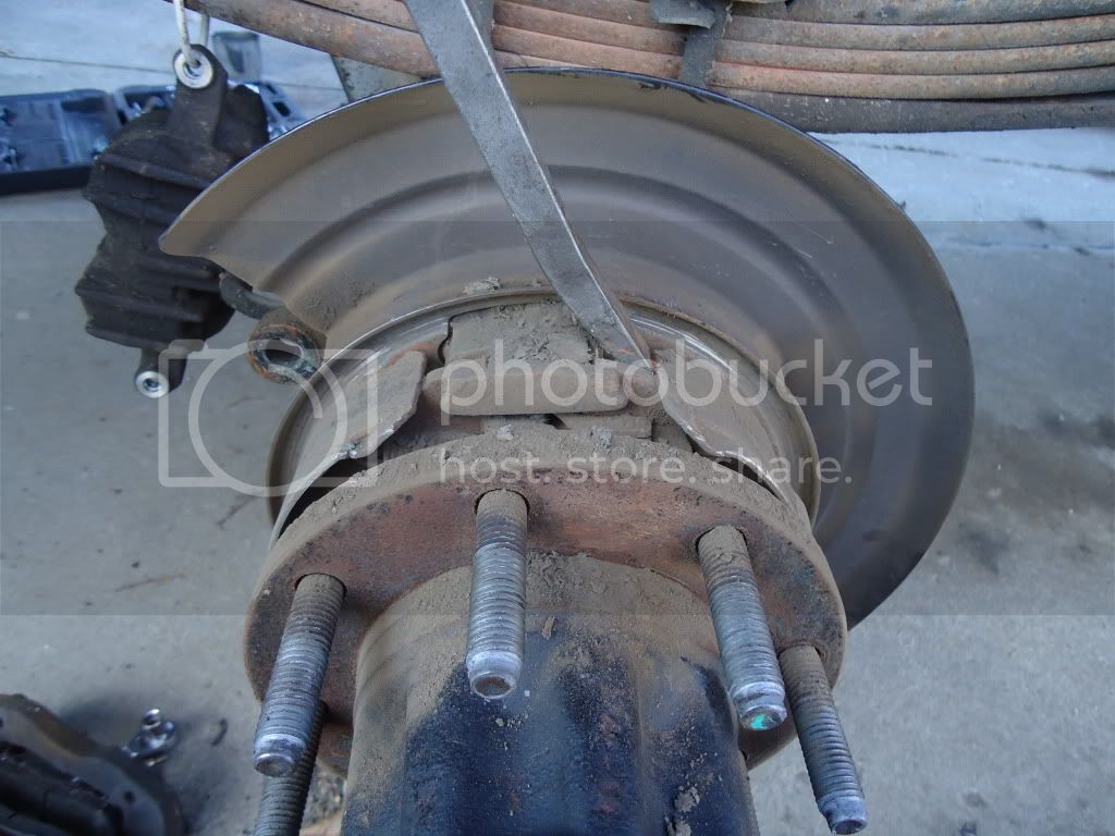

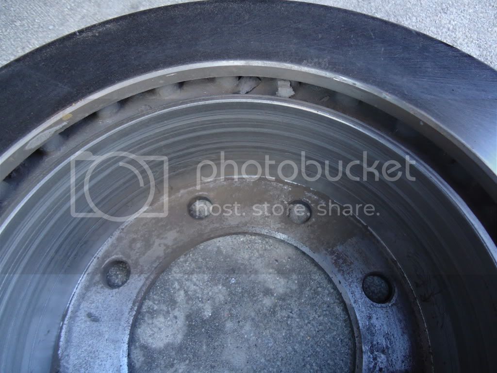

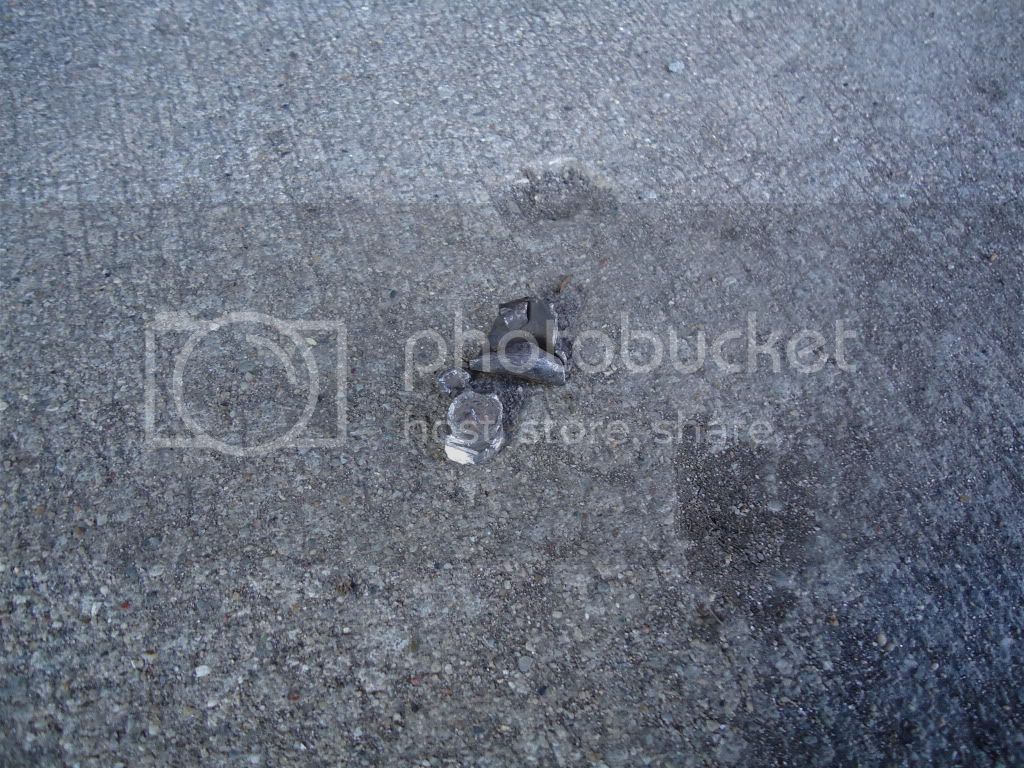

e brakes... gut em, or replace everything.. i was reversing once and heard a BANG and the truck dead stopped... i went on forward and they broke free...
TyCorr
Jun 23, 2011
15,461
Mine were doing that! I used to use them several times per day and they always worked. Then I stopped driving using the truck and it went to hell quick. I unhooked the ebrake until I can fully rebuild it all. Trucks dont like being driven 30-40k a year and then abruptly switched to grocery getter duty.
