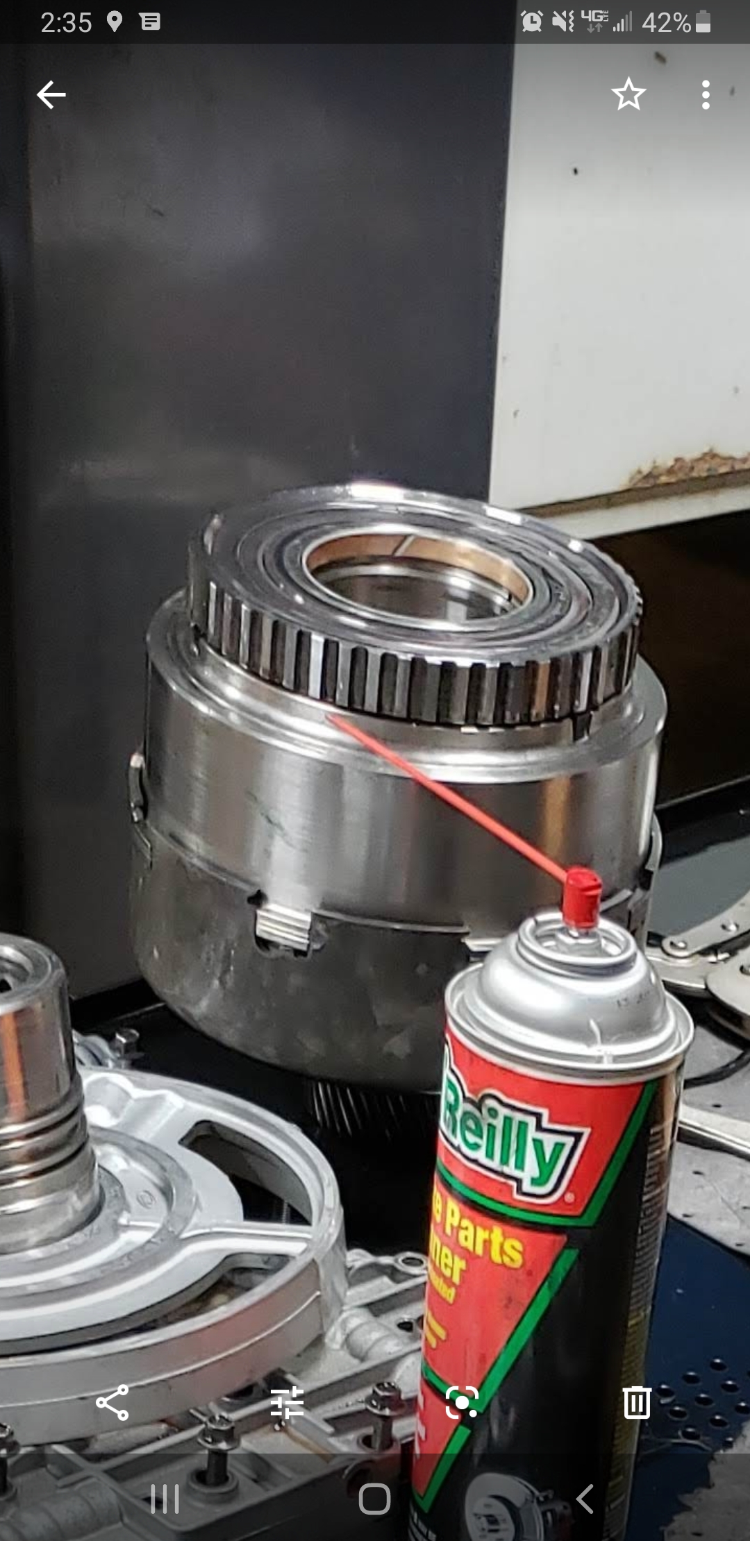

Rebuilt my 4R!

Dont see teeth on the hub.. Thats means its a sprag not a mechanical diode. Only know this from the and hours hours of research done before I rebuilt my 4r100. Its easy to Google the diode and see how different it looks.

So I mean..... Like.... If that's the updated version and I'm good to go..... Ima beat the **** out of this thing.

Bet you won’t....
LOL
My bud picked up a LLY an we were screwing around tonight. I slowed under a bridge and let er eat.. Full throttle 30-90 mph run.
She holds good
