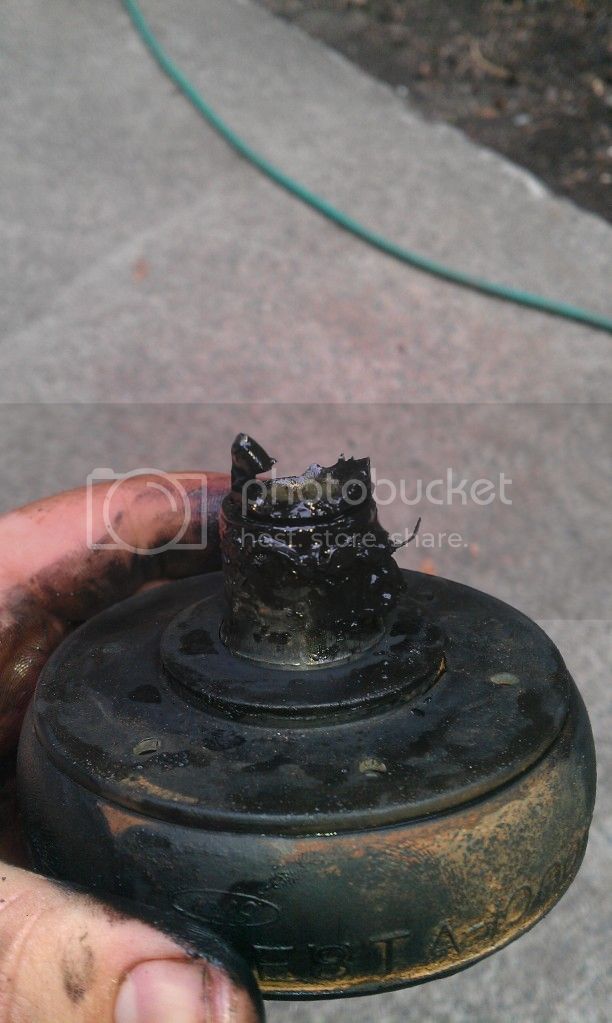

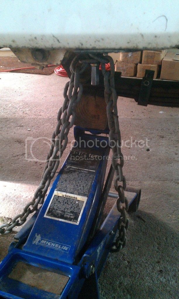

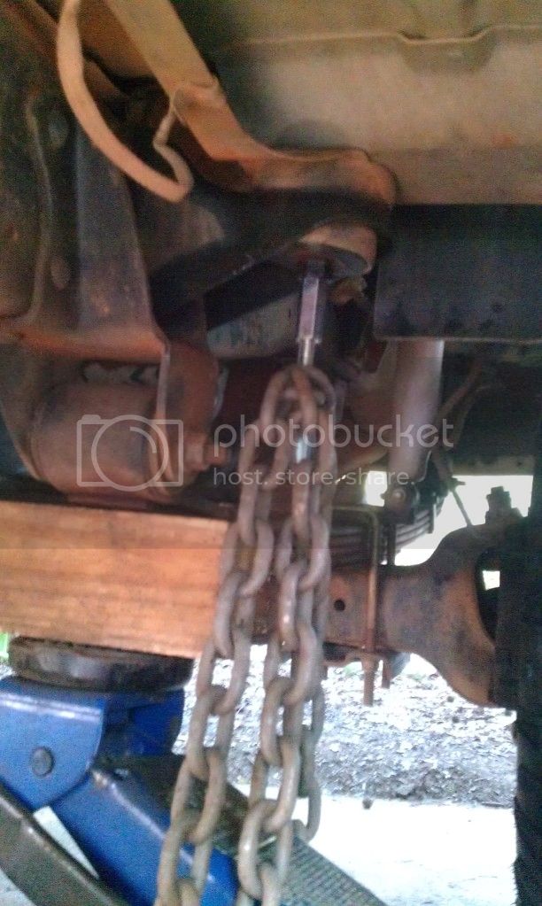

Hey Denver, I wish mine was that smooth. We started with the worst one which was the passenger side middle mount and it was a PITA. We have been using the jack and chain puller method and at first we broke the nut off the bottom sleeve, pulled the factory welds right out. Unfortunately don't have a picture of that. Then welded the nut back on and the next time, the bottom sleeve broke off inside the top sleeve. But hey, we got it out so I didn't care. The other side middle mount was easy. Last mount I have left is the one above the tank. Going to try and hammer it down from the top before I move the tank out of the way. It was too late last night to try any hammering so I'm gonna have to try it this afternoon after work. Having a buddy helping me with most of this work has been a big help.
Here's a picture of the broke sleeve:
And a picture of our pulling method:
