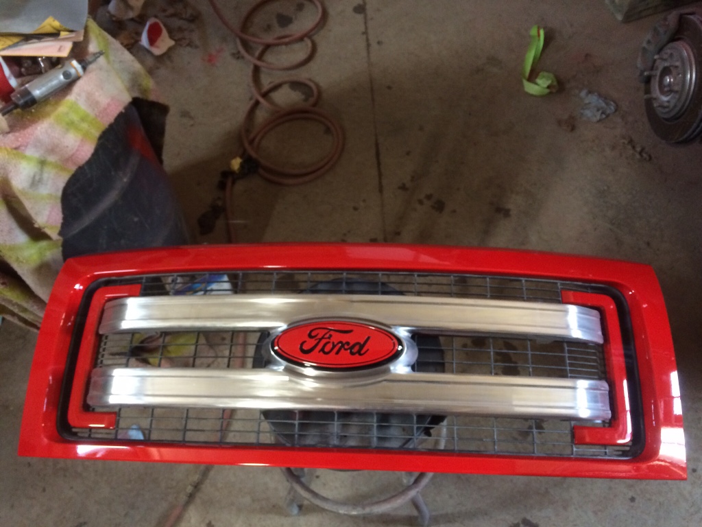

umm. i did it. what does that tell ya? lol
I did this emblem. The silver was not my choice. It's just as easy as I described.

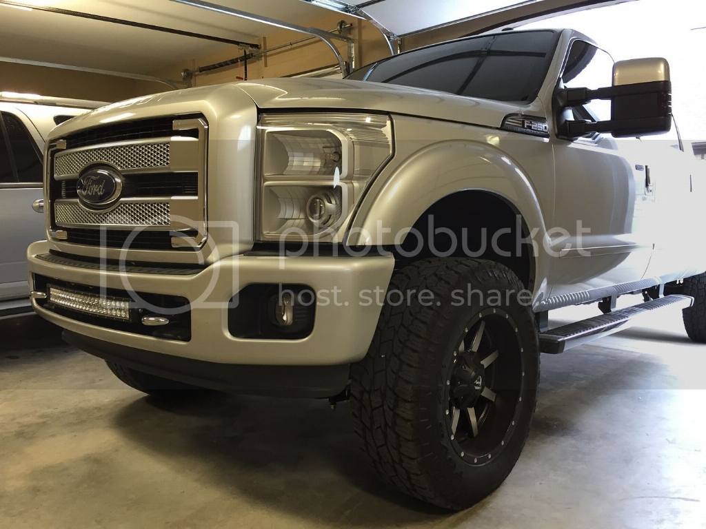

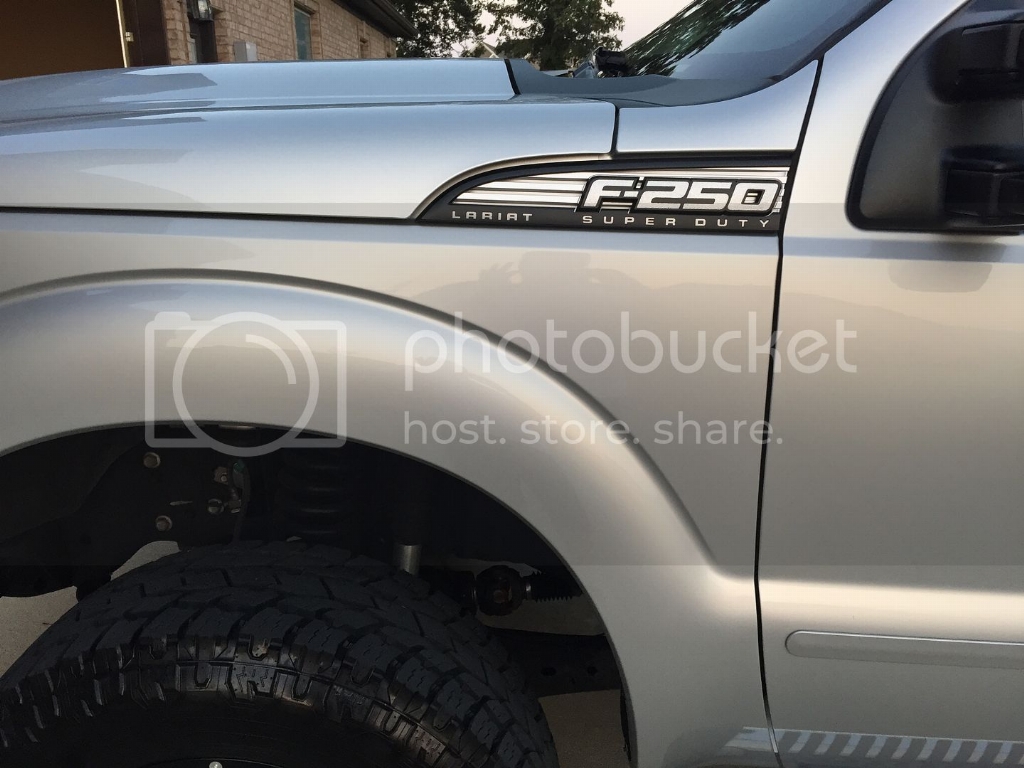

I haven't done the front and rear emblems but the fender emblems will come apart without messing the clips up..... or at least the did on my '15. Paint I used was from Automotive Touch Up and it matches great. I've used them several times including the paint for my headlights and every can has been perfect. Sand a bit, use some of their adhesion promoter, few light coats of primer, few light coats of body color and then a couple coats of clear.

That's what it looked like, just checking. I've been wanting a shop to do it for a long time. I've had the PTM grill shell in my garage for a year now.. Going to order the paint and other stuff today.

The entire front end of your truck looks great I really like the headlights done on the silver trucks
