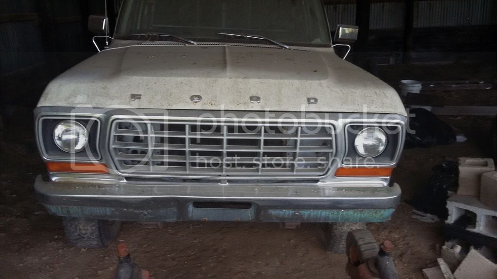

Maybe time for some round headlights?
Who couldn't love this, lol.
I think the rims should stay if they can be cleaned up good.
I've considered going back to the true 77 front end. But the only way I'd go round headlights is with the split grill too. Although, I've always been partial to the later style like mine is now....square lights and one piece grill.
I've had 2 different people in the past few weeks go "yay, it's Tennessee Vols orange". This keeps happening, and it'll be in the body shop getting a new color.....
