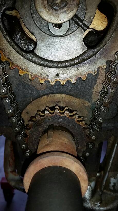

One thing that puzzled me a little during teardown....supposedly this thing has never been completely apart, came out of a running/driving car....but the timing marks looked like this...

Could be a stretched timing chain... Id get a nice double roller setup since ou got it apart.

Didn't think about that. Also didn't know HO engines came with double rollers. At least that's what this one is.

Not sure on the block castings. The ho motors are not a true double roller, its a double chain, the roller is up for argument... LOL. There are much better setups you can get, as far as the roller part of tye chain.
