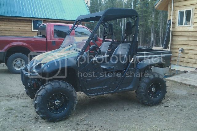

New wheels and tires mounted up!
907DAVE
2,166
AK
They are a pretty good multipurpose tire, not the best for deep mud but do pretty good.

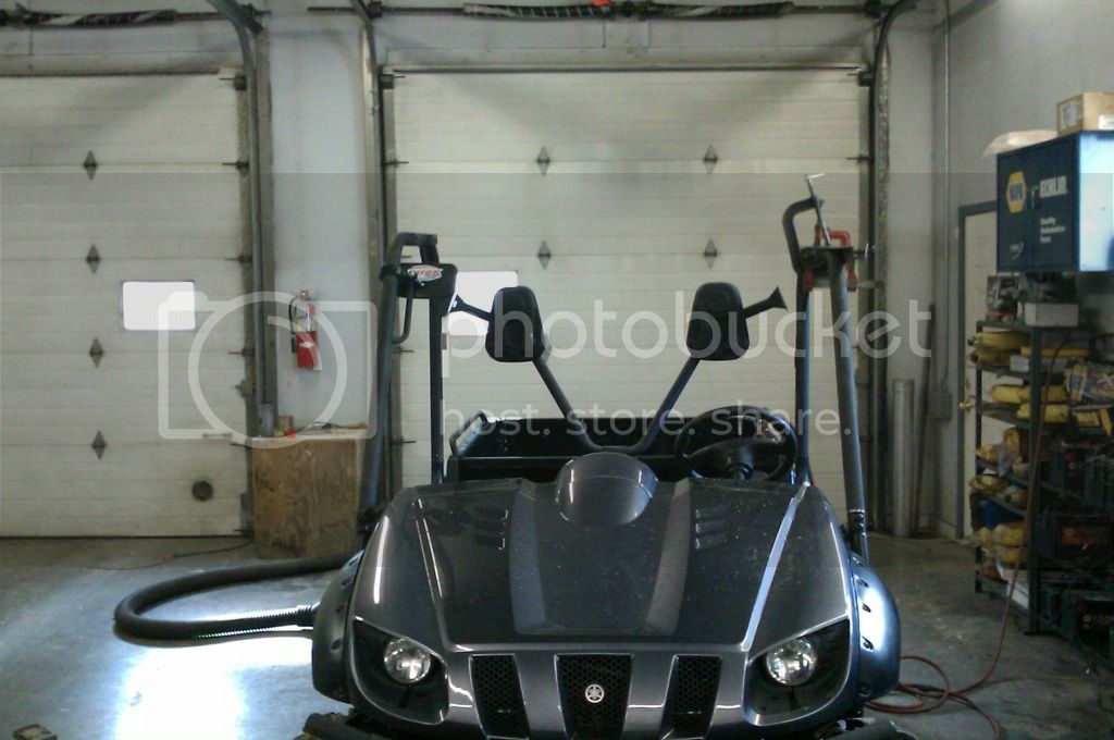

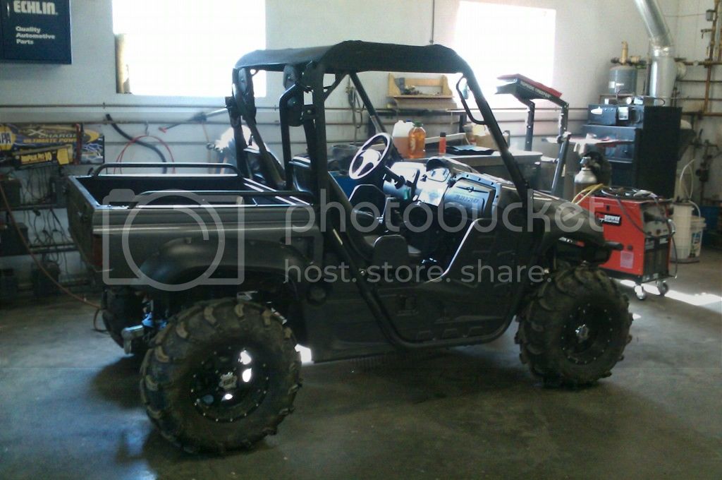

I lowered the cage 3.5" today and added a bit more lighting.
Of course I had to drive it over the last few nights worth of work.
I plan on changing out the primary sheave, weights and secondary spring here soon.
What was your reasoning behind lowing the roll cage? Let us know how the primary sheave, weights, and secondary spring go. I was looking at doing this to mine. Whose kit are you going to use? Looks bad ass tho keep up the great work.

I wanted a little extra clearance for the low hanging tree's on the trails, plus the factory cage looks goofy at full height.
I currently have a EPI clutch kit and sheave from White Knuckle but I am considering switching to the Hunterworks greaseless setup.
