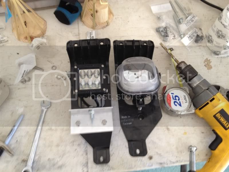

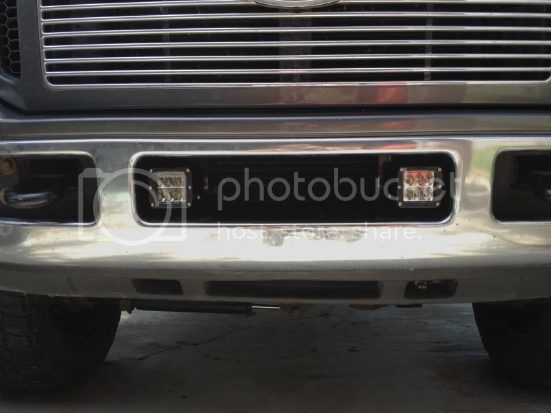

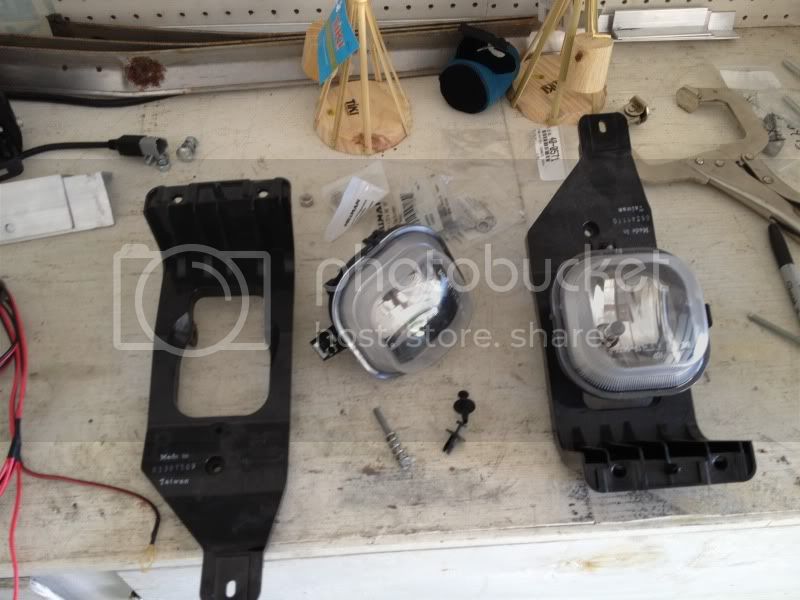

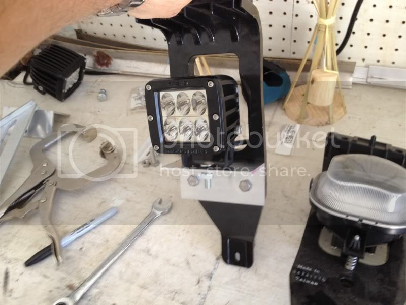

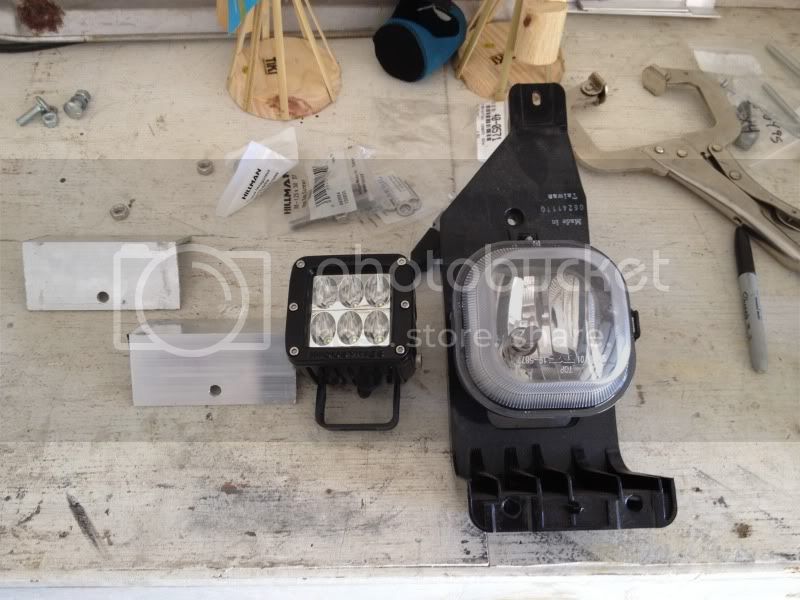

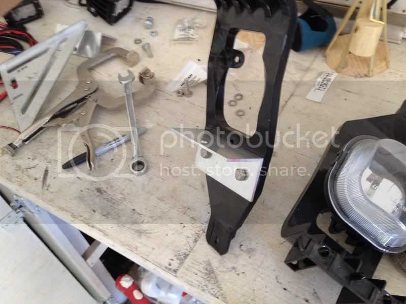

Here is some pictures of how I did it using the stock fog light brackets.
Took stock fogs off
Using 2" aluminum angle to mount the led's to, I got them them where I wanted and bolted them to the stock bracket
Drilled a hole in the center on top to mount led
Bolt them to the bumper you end up with this
