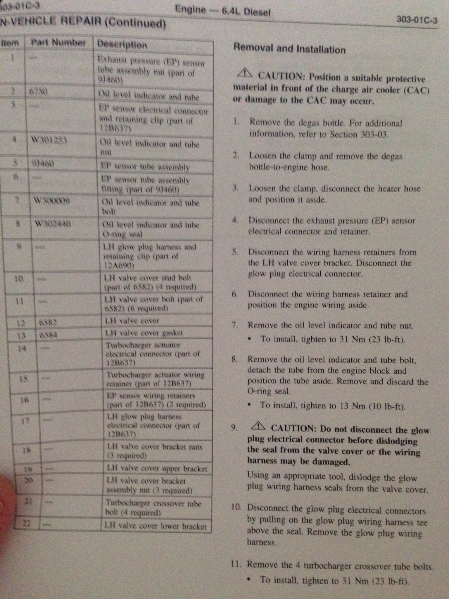

Thanks for the feed back, can anyone help clear up step 9? Are special tools required? Thanks again

They can be a pita. I just used a flat head screw driver to get the seal free from the valve cover. It can be a biotch to put back in. It felt like I was about to break my thumbs from pushing so hard to pop it back in. But if you do it just right it will pop back in. The special tool I used was my fingers and I only damaged my pass side gp harness a little bit on cylinder 5

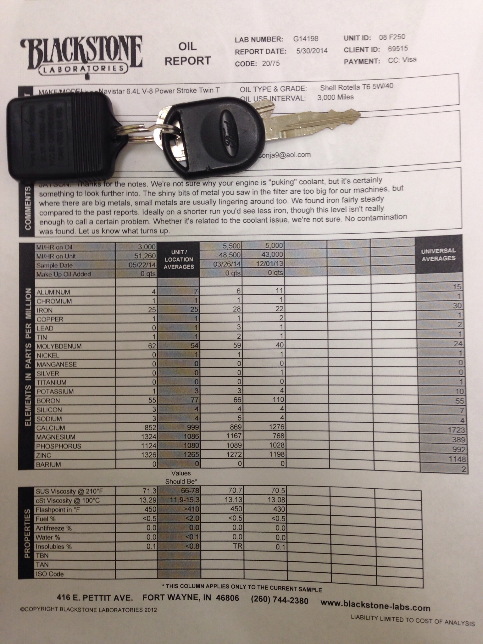

I've tried that test & it actually stays but I do have an aftermarket MPD CCV cap that's heavier than the stock cap & it does stay put.. I will try the factory cap & see if that blows off. Truck runs strong, blowby doesn't puff to me. also blackstone reports seem good & im currently waiting on a report too.
It all started w/the tick I've been hearing, now popping around intake area, then while on a highway run ( boosted 40+psi ) & puked but only on highway runs. The mechanic did a fan clutch for me last yr so that's why I went to talk w/him about current issues but seems like the guy doesn't want to work on 6.4's anymore. IDK, I got a shop manual so looks like I'll be going deeper myself. Thanks again, sorry for the derail here. Jayson
