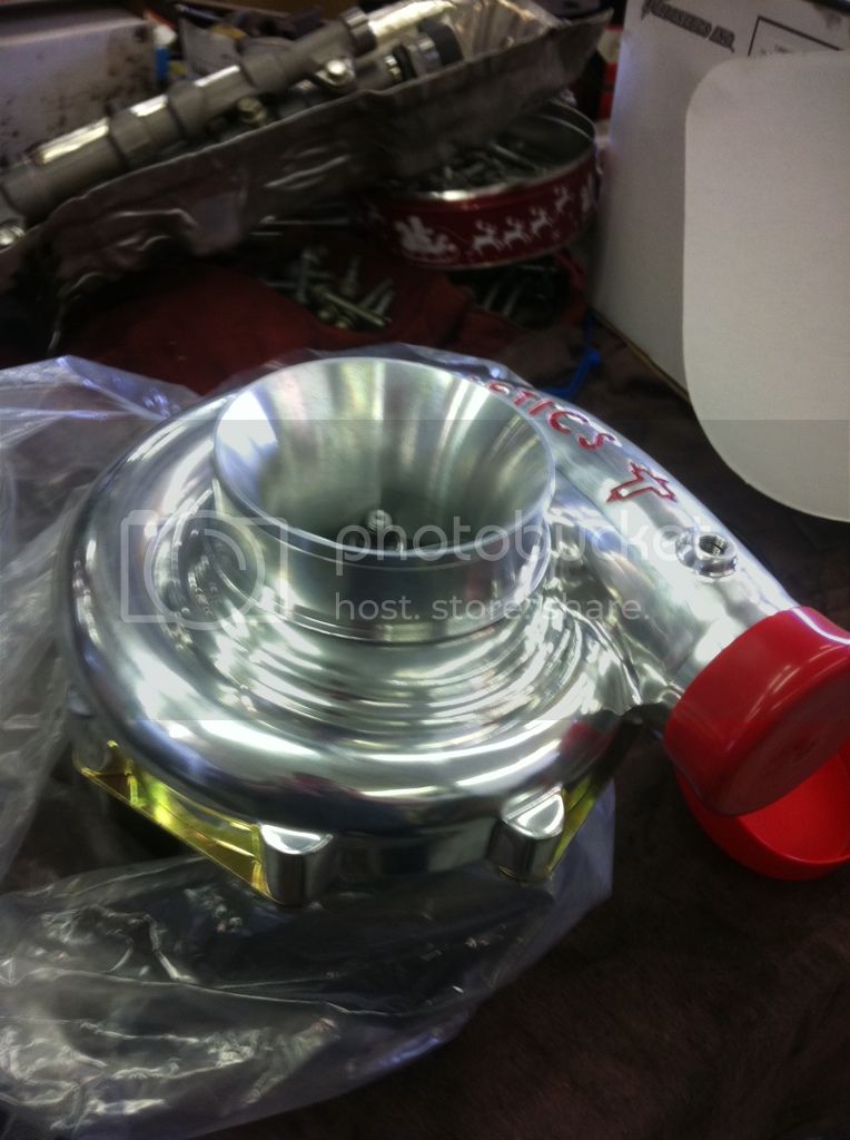

This is my now turbo it's great
This is my up pipes and manifolds
I went from 100 nozzles to 75 nozzles
I like them alot better they don't haze like 100 s do
