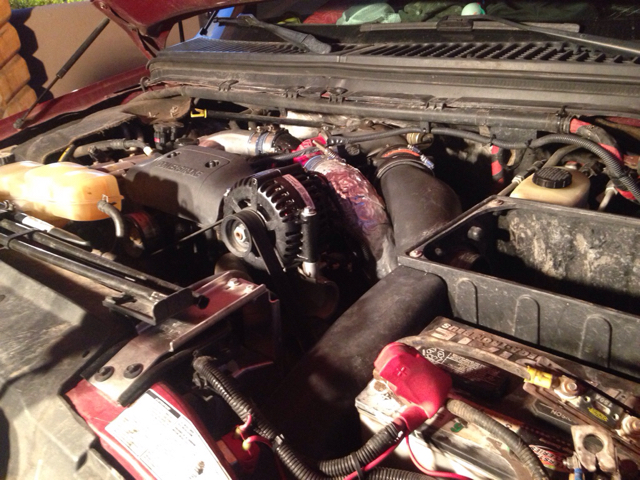

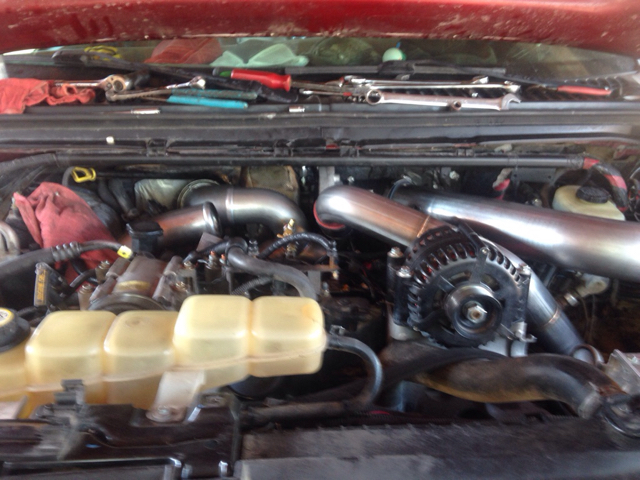

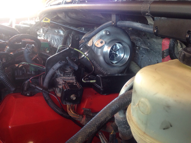

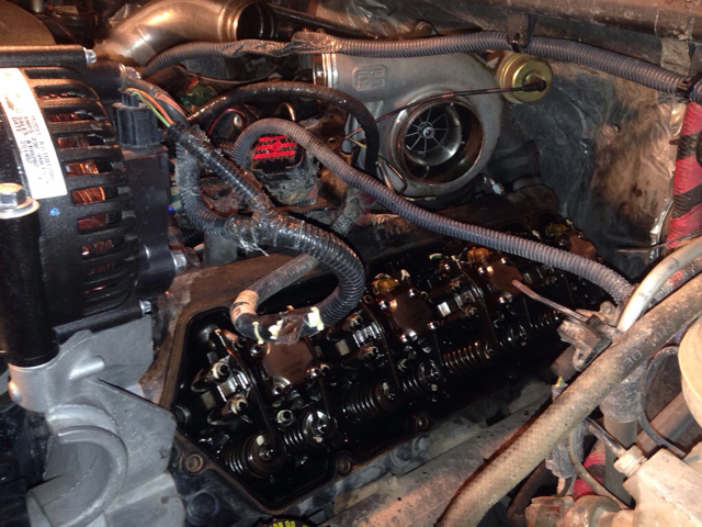

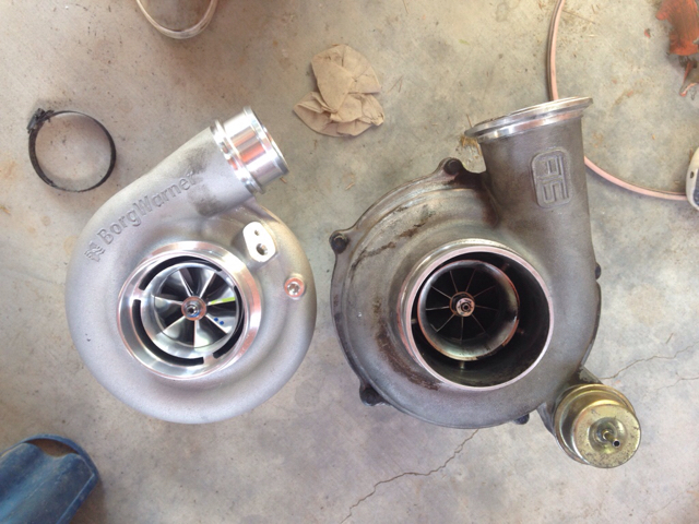

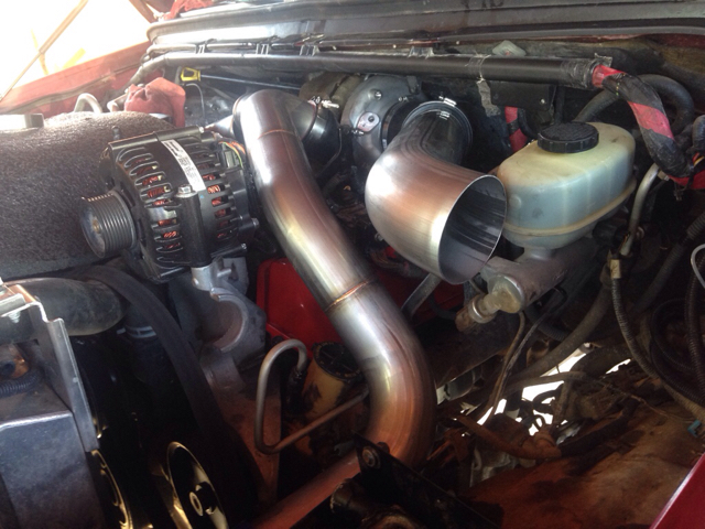

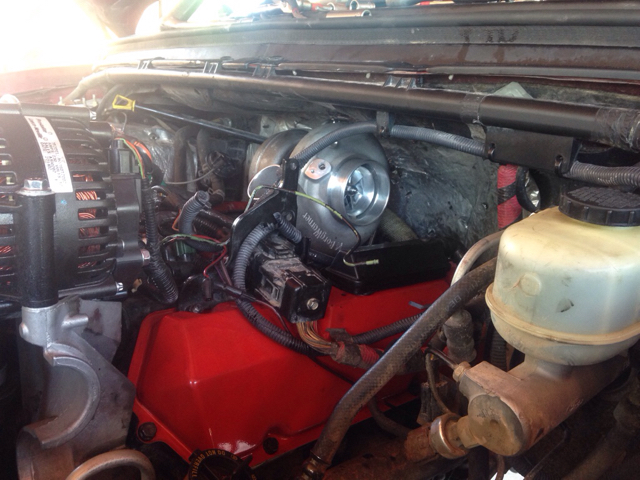

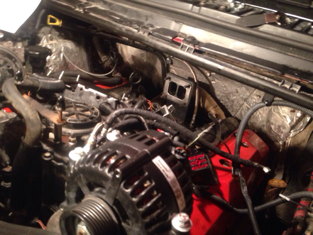

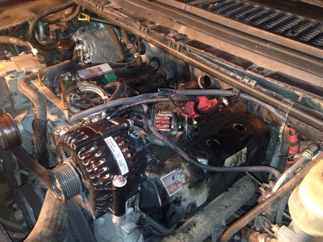

Hadn't heard or seen a 7.3 with a 369, seen a few with 366's so me and my friend took a little gamble to see what we came up with, we got with irate diesel and ordered their kit, called swamps and discussed injector sizing with them, we ended up settling on 220/30's and also added a hydra chip to the deal, (his TS was acting up) so we took this fine weekend to put it all on, the truck is alive and well, runs real smooth with stock drive ability and spool up, were lacking on the Hydra though after a malfunction with the unit (having a new one sent) so we haven't seen the trucks full potential yet! Getting pretty anxious to see what it'll do!

In the one pic it looks like your running a waste gate on the 369??? What's with that ?

Is he running the .91 or 1.0 housing?
