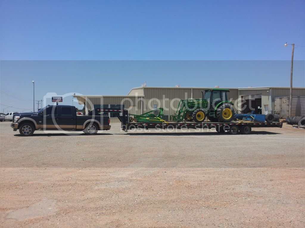

Thats crazy I know I have a F350 but my trailer weighs in right at 8k lbs empty and hauled a 21k lb dozer on it a few months back and it wasnt sitting on the stops but it was hitting the overloads on bumps ha

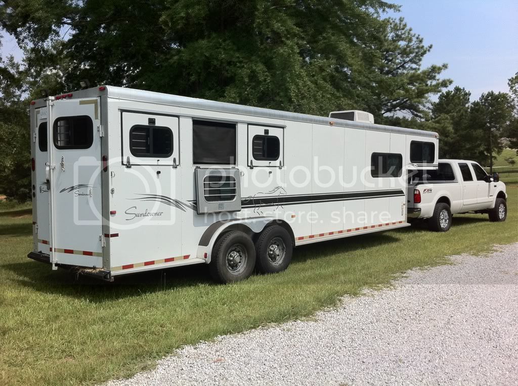

That sucks. My '03 never sat that low, with a similar trailer. This truck had a leveling kit with 33's as well, so it looks worse than it should. 150k miles on the stock F-250 rear springs.

Might wanna adjust the neck a little too, trailer looks pretty level. Might be trying to pick up the whole trailer. Ford did pussy them up a little.

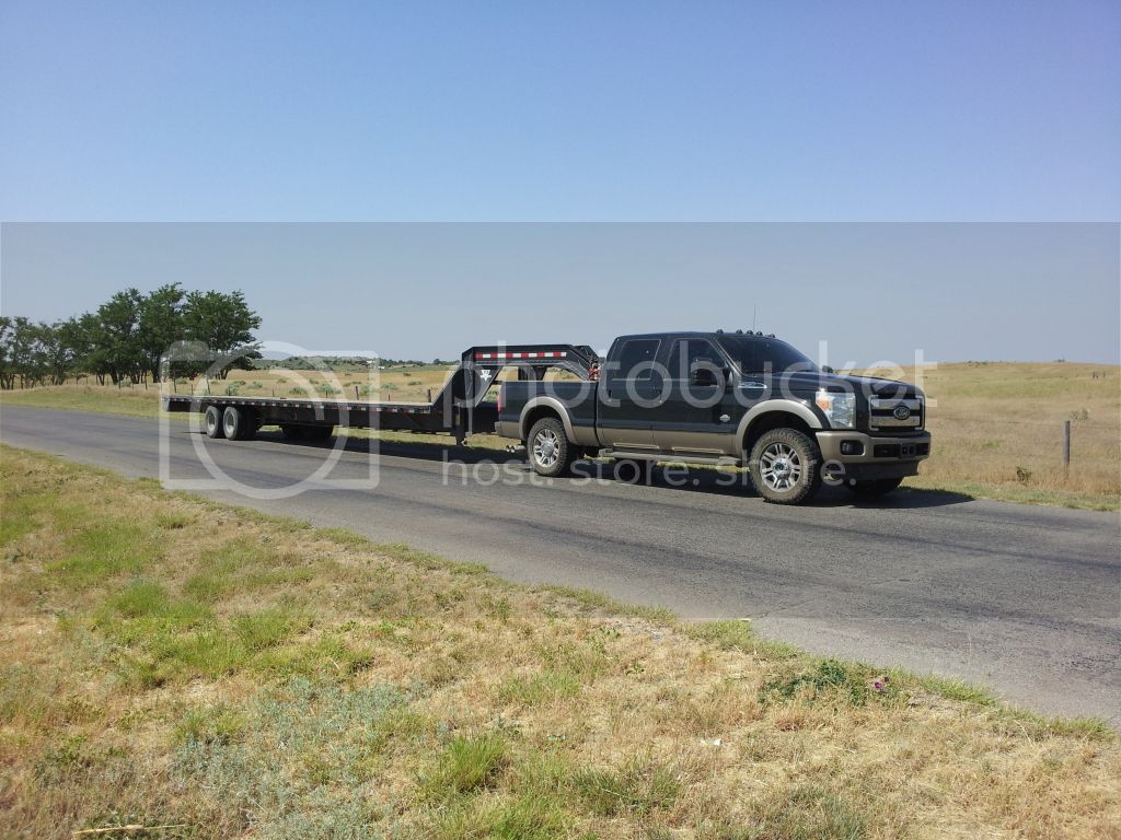

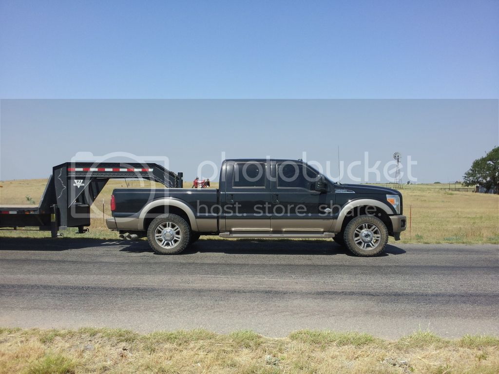

That trailer has way to much tounge wait, your towing that heavy with a short bed truck, and if its a 250 it has less leafs than the 350s and nearly everyone ive seen doesnt have a set of overload springs. It needs some air bags or a full set of beafed up springs. Like some others have said. it dont take much and i can set my truck down on the over loads but once they hit the overloads it takes a heck of a load to get it sag any more.
i also agree with weight distrabution. if you just had hunting gear in the back and the front is a living quaters then you have way to much weight in the front and not enought in the back to level it back out.

This is with a 4 inch block in the rear. pulling this trailer without it would put the truck within a 1/4 inch of the bumps and it would hit on a bumpy road. The 250's dont have factory overloads
Since I put a 4 inch block in it got rid of the factory stoppers but if it still had them even with this 4 inch block it would have been on them.

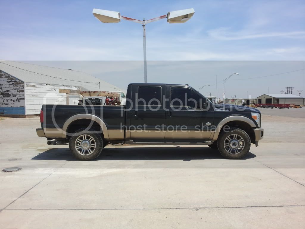

This is how the truck sits without a trailer.
And to be honest my 6.4 squats just as bad as my 6.7.
