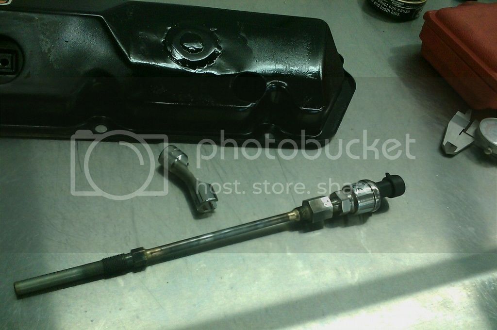

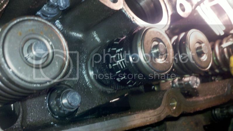

Maybe I'll do a write up later but I'm lazy. This is how you measure installed height.

How.... All the valves can't set at the exact same height after 200k Miles, some have to be worn more than the others no? If a valve sets farther in the head than another valve , even if by only .010 and you set all the valve heights to 1.750 ( for example ) wouldn't that mean its not shimmed as much as the next valve, or shimmed too much depending on how much wear is on the seats? Or am I totally missing the bus on this one
If one is shimmed more to reach the 1.750 it would have less seat pressure than the other ......right ?
sent while trying not to JJ My rods!!!!!!
907DAVE
May 21, 2011
2,166
AK
Yeah, don't think your following. If you the valve sets deeper into the head, it protrudes out the other side further - this is what you are shimming for.
Just because one valve may be shimmed more than another does not mean the installed height will somehow be different. As long as all the spring are "compressed" to the same height they will all have the same (very similar) set pressures.
littleredstroker
Jun 22, 2011
3,720
where the antelope play
I guess I was thinking you measure from the head, not the shims .. your saying you measure from the top of the shims, Right?
