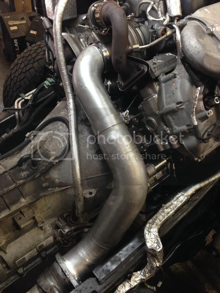

I have the SDP Downpipe it's worth the $ has a deeper sound cooler egt's an better throttle response. Holder's Diesel Installed mine

How does one get at the clamp that holds the downpipe to the turbo. The 6.4 is easy to get at for the most part, but on the 6.7 you cant even see the turbo.
Pull the right side fender liner out. It's a long reach but it can be done. Or you could pull the intake manifold off to access it from the top. The intakes come off real easily.

The clamp that's at the turbo, what a ******* pain in the azz. Bolt was facing the drivers side so couldn't reach it from the passenger side. Removed the intake and the heat shield and loosend the bolt. Clamp would not budge, WOW. After about an hour, finally got it to open and bent the bolt. Bought another clamp and just put it on. Looks good but a pain to install cab on.
