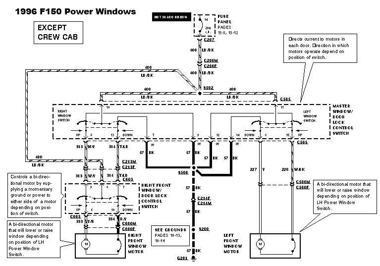

Found a wiring diagram for a f150, maybe check the wire colors and see if they match what you have.
But you could have a bad harness, shorted where it passes through the door. Or someplace else.
Also could be a bad master switch on the driver's door.

So here’s what I have figured out. If I jump the wires from the motor to the switch, and reverse them it will go up. But only the top part of the switch works. The blue with black stripe is constantly powered. What I think the issue is, which I will experiment with tomorrow, is the light brown/blue stripe is the culprit. That seems to be the bottom constant. So, one can theoretically assume that it should be constantly powered as the blue/black stripe is.
I think this might have saved me. Thank you for giving me the diagram

Just as an update for all I figured out what was going on. So, I found a few wires that were broken going from the drivers side to the passenger. Whatever teenager owned this before had no idea what they were doing. Once I figured out the ground issues, I realized it worked but the switch was backwards. Ultimately it was the wiring to the motor itself. From the new motor, the plug was wired in backwards. So I cut the wires going to the plug from the loom side and reversed them. Now everything works as it should.
