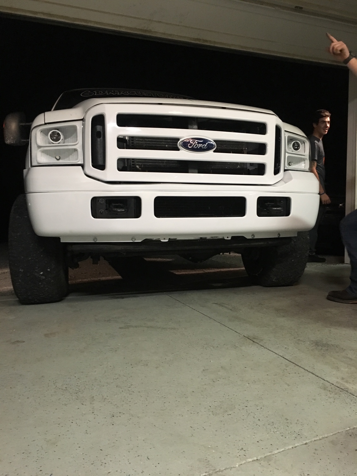

Nothing to crazy to update, but got my front end done finally. I love it!
I separated from the Air Force last month and got a sweet job at DNR Customs in Casco Michigan, our dyno/drag day is September 10th at Milan Dragway. I'll be throwing the nitrous on and getting on the rollers to see how she does. Going to run 12.0 index as well so hopefully she'll be good!
