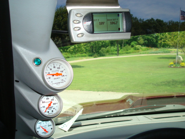

All of the kits come with an arming switch to turn on the system. I can have my switch turned on all the time, but it wont actually start injecting anything till it hits the preset boost starting point. And when it does my green LED indicator light will light up to let me know that's injecting already.
This is my old gauge setup, but i'm still using the same LED next to the pyro in my new gauge setup. This way i see the LED light up and look at the EGT's to see how they're doing when it's injecting.
